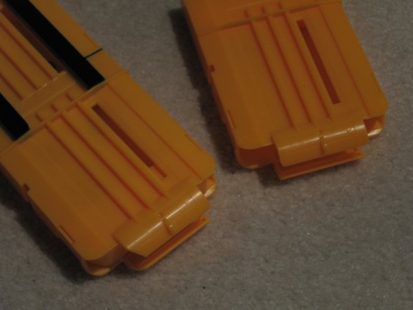

So that I don't have to answer this so frequently.
When a stronger spring is added to the plunger the bolt sits slightly further forward when the plunger is primed. The solution is to trim the rear lip on the magazine so that it is clear of the bolt. Like the left one pictured here.
