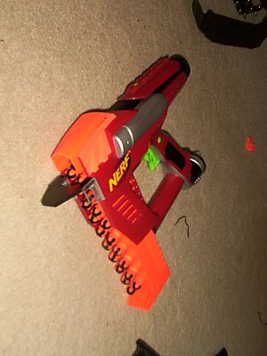

The gun is so light that I don't really need two hands to aim it, but should I want a more stable aim I can grab the frame of the gun where the stock pump used to be. That's the main reason why I left that part of the shell there.

If I buy another gun I'll just be modifying it the same way as this one and then dual weilding them off of the same tank. Or, when I get around to making my own clips I can see if longer clips will even work.

I'm sticking with the one clip ontil I have the materials I need to make my own clips for this. Won't be very hard for me, provided I can get ahold of the PETG or polycarbonate tubing I need. I may have to use aluminum if I can't get ahold of either of those.

I finished the CAD model for the custom clip last night. The barrels will have to be made out of aluminum because it's the only affordable material I can locate that comes in the right dimensions. 8 Feet of 6063 tubing with a .527" ID and 5/8" OD is a meager $7.
I'll use it to explore different barrel lengths and higher clip capacities next week.

Anyway, once I got to the machine shop I got the clip sanded down and I discovered an unexpected issue with sawing the front of the gun off. The ABS plastic isn't rigid enough, so when the clip is inserted it prys the two halves of the front apart so that the green spring-loaded tooth thingy that interacts with the sides of the clip can't do its job. I need to either stiffen the sides of the body shell, or just make a small frame piece for the front of the gun to keep it from flexing.
I also got the regulator dialed in to the right pressure level so that should I fill the tank to a higher level the gun will still operate at a safe pressure.

There. I added a small bolt-on adjustable piece to reinforce the front.
All done.

It's somewhere around 70 feet. About the same as the at3k I modified. I should be able to get improved ranges once I get the custom clip made so that I can have a more effective barrel length.
Omega, on Oct 21 2006, 02:09 PM, said:
If you were to post a writeup... Nerfers all over the nation would be calling down blessings on your merry, learned head.
Joining the two clips together requires some very precise cutting and glueing. I had to use a wide variety of tools to accomplish it and I don't really want to try doing it again just to make a writeup (atleast not right now).
On the other hand, modifying the gun to accept a larger clip is a piece of cake, you simply need to hack off the lower front of the gun that acts as the floor for the clip. Just don't remove the green foregrip completely like I did.
Then you relocate the stock pump to the outside or replace it with a bike pump.

I can squeeze off one or two darts at a time, which is primarily how this will be used if/when I attend a war. The brace I made for the front of the gun allows me to adjust the clamping tension on the clip so that it doesn't slide back down after I partially empty it.
The ROF is so high at 50-60psi that it's kind of difficult to fire just a single dart.
