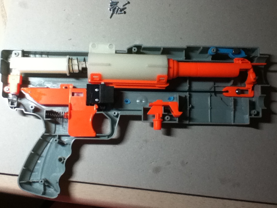

3 shots into owning this, and I'm already disassembling it lol
Screws on the right side of the shell. Use a flathead to pry off the nozzle by going under. Most of the adhesive on my model is on the left side of the blaster.
and it's off. This is a bit annoying, and in reassembly I'm going to tap it so it's held in place with a screw or
Don't leave the nozzle off, or a very important pin will fall out. That pin is essential for the function of the blaster, and a bit finicky. Be very fucking careful removing the shell halfs from another.
BuzzBee and their retention plates. It's easy to remove with a flat head to pry off the grip plates and expose a hidden screw.
Internals. Again, be really careful lifting the shell up and apart because there's a lock pin up front that is like a dart tooth but opens on trigger pull. This is so the dart seats in the barrel. A smaller version compared to the Sentinels dart tooth and displayed on the Champion and BuzzBee M16. The internals are nearly identical to the Champions
Up close of rear near the trigger group. A bit hard to see but similar to the rest of the Ultra Tek springer blasters.
Up close of the front. Trigger pulled, so the "dart tooth: is down. Be careful disassembling because some of the pieces are finicky and loose. Don't fuck with this if you don't have to
This piece is finicky as fuck. I said don't take it out, now it's a hassle to put it in. ;)
spring mount has a larger flared plate, seems like it can accommodate a larger spring. Maybe easier to put a larger spring on? Didn't test.
lockbox. Just a trigger lock, can't disassemble but easily removable or reinstalled. Easy to remove and put back, which is cool and nice. If you want to remove it, up to you but I took it out just for de-priming reasons.
