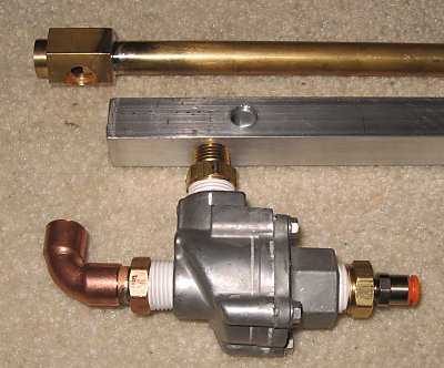

Soldered the barrel to the receiver and soldered a short section of 1/2" brass tubing to the drilled plug to make a tubing adapter.
Also lathed down the ramrod to match the new receiver design.
Tomorrow I have to drill and tap a new port in the inline air tank after measuring out where the QEV belongs.

Have you decided which QEV and directional control valve you're going to use?
-Knowledge Is Power-
#104 CaptainSlug
Posted 08 August 2008 - 11:49 PM
Yes.
I already have a push-button directional control valve that I bought last year but never got around to returning.

Looks nice and compact.
Is the air chamber port of your QEV off at a slight angle? That port on my QEV is off slightly and it's somewhat noticeable. I'm wondering if it was just a defect in my valve. Yours appears straight.
The thread on the exhaust port of mine it a bit off-kilter too.
I think its a manufacturing defect. My QEV has it to, you could shoot McMaster an email I suppose.
