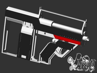

Posted 03 March 2008 - 04:22 AM
Will be less cramped, easier to machine, a little bit lighter, and will hopefully have a much more reliable trigger setup.
I've also figured out how to control the speed of the ramrod forward stroke without limiting the speed of the retract stroke. This setup will be getting a SIGNIFICANTLY higher flow rate than what ABP5k had and includes a much higher operating volume (7ci).
I have high hopes for the performance of the new configuration. I will be tackling this head-on after ECNO.

#79
Posted 03 March 2008 - 07:21 AM
Anyone else think that that thing looks like the matilda from RE4? I like the design and look.I've made ALOT of revisions to the design of both the gun and the valve/trigger configuration of this gun. I'm trying to simplify and reinforce everything. I don't really want to go into too much detail on what all of the changes mean, but here's the revised CAD design.

Posted 03 March 2008 - 02:18 PM
You put your other hand on another ARR.Also, the new design doesn't look like it will have a place to put the other hand like every bullpup assault rifle that ever existed.
Dur.

#86
Posted 04 March 2008 - 12:42 AM
It doesn't need one. But if I decide it does I can just make one that attaches to the hardpoint holes in the side of the gun.

#88
Posted 04 March 2008 - 08:47 AM
I've used a titan and let me tell you, you want someplace to put the other hand.
This comment just makes me scratch my head. This weapon is in form, function, and operation entirely different than the Titan. In fact, I'm having trouble drawing any comparisons aside from the fact that both release bursts of air in order to propell their projectiles.
While I am apt to agree that a weapon which negates the need for a sidearm (as the ARR! appears to represent) generally is more comfortable with a foregrip of some sort, to draw comparisons between what is essentially a machine pistol and rocket launcher converted to fire darts in terms of ergonomics is completely useless.

#90
Posted 04 March 2008 - 01:24 PM
I can decide later if I want to add a foregrip so it's not really worth debating about it right now.

#93
Posted 26 March 2008 - 06:55 PM
It's going to work pretty much the same way ABP5K did.I hate to play the ignorant one, but I'm having trouble understanding the air circuit, could you lay it out for us? I really like the aesthetics of the design, I just want to understand how it works.
Only in this gun I'm using a ramrod which is linked to dual-acting cylinder which will retract when pressurized, and extend when depressurized.
Instead of trying to make a chunky high-flow directional control valve I'm going to make one chunky dump valve and use an off-the shelf Normally open push-button valve.
And that's all I feel like explaining for now. I will start the next phase of construction sometime soon.

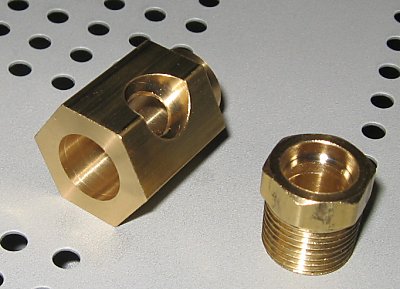

Posted 06 August 2008 - 08:18 PM
Made the receiver and part of a tube adapter.
Edited by CaptainSlug, 06 August 2008 - 08:18 PM.
