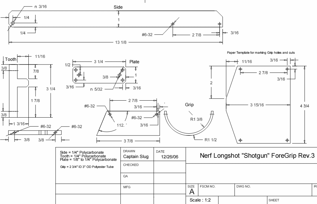

The Foregrip Revision 3 prototype is finished. I had to change how the half-tube grip attaches and the end result is that the new kit WILL NOT INVOLVE the use of solvents in any way, making the kit easier for me to construct and will increase consistency and durability.
Hardware count is
+ One 4-Inch Length #8-32 threaded rod
+ Two #8 1/4" spacers
+ Four #8 hex nuts
+ Twelve #6-32 screws
Tools required
+ Tablesaw
+ Scrollsaw or bandsaw
+ Drillpress
+ #6-32 Tap
Mechanical Drawings
http://www.captainsl...rf/lsgrip-3.gif
I'M NOT SELLING THESE ANYMORE, SO STOP ASKING.
