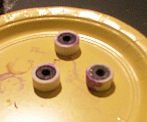

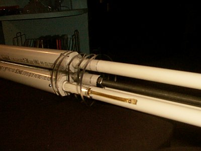

I got the PVC stoppers made. These prevent the stefans from being sucked into the plunger chamber and also act as a stopper for the barrel/breech. I didn't want to wait to go to the machine shop so I simply cut short lengths of the 1/2" PVC Type I round rod and shaved them down a time bit using my drillpress as an impromptu lathe. I then epoxied the stoppers into a section of 1/2" PVC.
I manually test-fired one of the barrels with brass inserts while in the basement this afternoon and the dart shot all the way across the basement, deflected off the partly-opened door on the other side and disappeared into the storage room. So the 50-foot mark looks to be more than blown. I can do more manual testing once I get back from my trip and can get the breech holes cut, but it's no real suprise that I'm getting performance similar to what Carbon has been getting with the Snap model I based the essentials of this gun on. My setup only differs in that I'm using a longer spring.

I went to the machine shop this morning and got the breech holes and tracks done. Took alot of milling and X-acto knife carving. I also got the motor mount cut.
I'd do more today but my hands really hurt from all the cutting work. Plus I cut two of them...
Next I need to make the breech actuating sleeve and the actuating shoes and tracks for the plungers. Then I can move on to the outer shell.
Once I can get to the store and buy some loctite clear epoxy I can test the dry-firing to get a preview of the ranges. It's already looking very good but I'm anxious to see what it gets.

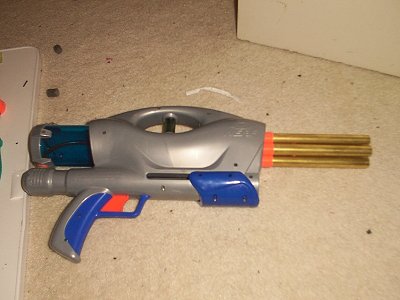

Slow day. I got the nested barrels and brass stand-offs epoxied together into a single piece so that the barrel/breech can now be actuated.
And out of dumb luck I discovered that if I make the breech track so that the breech is closed when the dart is picked up, then there is only enough space for a single dart to be grabbed. The breech will open as soon as access from the dart hopper is closed off. I may want to modify the advancing teeth to accomodate this change.
And I sanded the text off of the barrels.

Well crap. None of the adhesives I have were keeping the brass parts together. I need to go buy some 1/2 CPVC and then lathe it down to fit inside the 1/2 PVC so I can just use PVC adhesive to attach the breech actuators.

Slug, try JB weld epoxy. Works wonders on brass for me, even with a very small surface area to work with. And I'm sure you're familiar with the scuffing of the surfaces and whatnot already.
~ompa
#117 CaptainSlug
Posted 13 May 2006 - 11:41 AM
I'm just going to buy PETG for the barrels and then use IPS Weld-on plastic solvent to add the threaded stub that I need. Plastic solvent will give me a much more durable bond, especially since this will be a vital moving part.

The only parts potentially touching the inside of the 4" PVC shell would be the smooth-milled polycarbonate frame pieces. The internals will be suspended inside the shell, attached tothe center axle. So friction concerns will only be relevant to the advancing tracks that actuate the breeches and the plungers.
I may have to just knuckle down and lathe my own barrels. I really didn't want to have to because the drill bit required to do so is kind of pricey.
