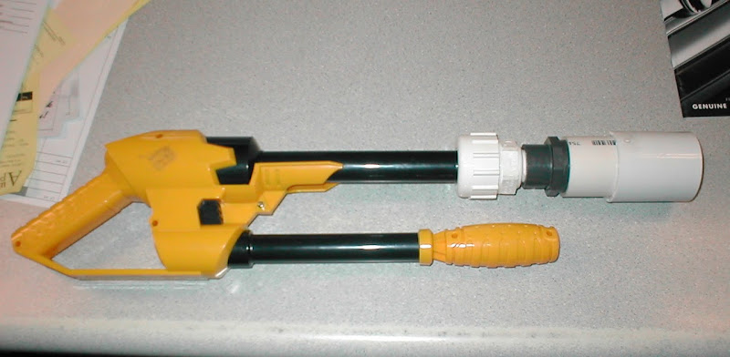

Beware of Uncle Milton's Balls!
I know, this one is actually a NatGeo, but my OTHER one is a Milton. I had planned on using this as my primary at the failed PWN war earlier this month. The big adapter on the end is a 3/4" Compression adapter, so it has a rubber gasket that compresses around the pressure cylinder, and male 3/4" IPS threads on the other end. The grey adapter is a SCH 80 female 3/4" to male 1-1/4" smooth pipe adapter. I actually load the balls by stuffing them inside the 1-1/4" end of the adapter, then sticking on the piece of 1-1/2" SCH 40 PVC, which I bored out to slip over the 1-1/4", which is in a 1-1/2" couple, with some thinwall 1-1/2" in the end. In hindsight, you could also just use a 1-1/4" to 1-1/2" adapter instead.
Anyway, when I max out the stock OPV, I get 60-70 foot ranges. Less if I use the silly light balls instead of my preferred yellow Target balls.
I also glued 1/2" copper coupler in to the compression adapter, which allows me to use a long (like 12" - 16") CPVC barrel for dart shots up to 150 feet. No joke. Flat. I shot my neighbor, across the street in his yard, from the back edge of my 126' long lot. Good thing he's in college, or he probably would have been pissed. :)
