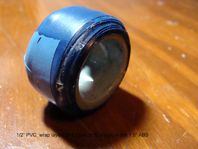

Deckel (Dachshund) Rifle
One of the easier homemades that is still able to become a respectable primary. It only uses commonly found materials and simply handyman tools, and it's cheap to make.
Time required: 4 hours
Total Cost: ~$20
Materials:
- 3ft length of 2x4 Canadian pine = $3
- 2.5ft length of 1.5" ABS = $3
- PVC coupler = $1
- 2ft of 1/2" CPVC = $3
- CPVC TEE = $.49
- Assorted screws = $3
- Zip-ties = $2
- Wire coat Hanger = Dry Cleaning
Tools needed: (more can be used)
- Saw
- Drill & bits
- Sandpaper
- Pliers
Link to Suggested Plunger Head instructions

What is your plunger head?

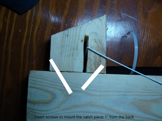

So the bent coat hanger is the catch, and the bungees pull it down? How does the trigger work exactly?
You push the coat hanger bit up using the CPVC I presume.

Posted 08 February 2010 - 02:26 PM
I question certain structural components of this blaster. Could you get a strong, but short, spring and just prime it and see if it will hold? It won't help with ranges, but priming stress at full load is regardless of power delivered to prime the blaster.
Yes and I have had about 25lb by using bungees, but I didn't fire the gun cause the bands broke...

Two things:
If you're right handed, tapping that CPVC is probably hard, I would rig up a keyring or coathanger rod for it.
Also, I would cut a hole for your thumb in that wood, like an L96A1 or WA2000 -

I use my middle finger to push it, but longer piece would be better.
And I don't own a drill bit large enough to make decent thumbhole, I'm working on it...

You made a nerf gun from a 2x4. Props. I am interested by your catch, but inclined to agree with Zorn. If the coathanger itself forms the catch, there's no way in hell it's gonna hold up under spring tension. Maybe try high-quality music wire or a thin steel rod instead.

early crossbows (real crossbows) used a lever and a dowel pin to trigger the crossbow. the string was in a groove over the hole for the dowelpin (like your hole in the extra block) the handle was tied to the stock and squeezing it up against the stock pushed the dowel up the groove and forced the string up out of the groove.
you could cut a groove in the wood below where the notch on your plunger sits. the wire could be bent into a rectangle and the ends could be bent down like a little handle. the dowel hole would be drilled up through the stock and hit the middle of your groove is sawn. drill a hole in your dowel tip for the tiny handle on the wire.
the dowel would be long enough to stick out the bottom of the stock. you could either push the dowel directly or use a handle like the crossbows used.
as a side note, the notch and dowel setup is pretty darn strong. a friend made a real crossbow completely out of hardwood and the string, no metal at all. a stray shot bounced off a forklift, a steel beam and then went through a 12 pack of soda, lengthwise! it could easily kill someone.

I wouldn't worry about the strength of the coathanger. The finishing nails I use for catchpins are half the gauge of coathanger wire, and probably only a little harder. It should be fine.
That was my original idea, but that would put my firing hand right beside my shoulder stock.
