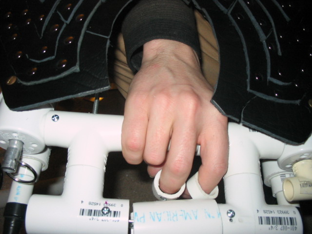

On to the night's improvements.
Figuring a way to attach the shield, while keeping it removable...I decided to use a "ciip-on" method, taking advantage of my various tubing sizes. I decided to use PVC rings and chicago screws to add clips to the shield, which then can just snap on to the body of the gun. Since the areas that I wanted to attach to were 1.25" PVC and 3/4" couplers, I could use rings of 1.25" couplers and 1.25" PVC. I know this little description isn't clear, but the following pictures should clear it up.....
And, how it all looks:
The underbelly:
I made a slight revision to the triggers, in that it's now "handed". I have it set up for a right-handed trigger, but that's easy enough to switch, by flipping around the trigger towers. I ended up going that route because I was having problems with the trigger pull using my ring finger....no quite enough leverage. The fix was both lucky and easy. I had only trimmed off one of my trigger pivots, inside the tee. I just attached the pull ring to the absolute end of the mending plate, and not I have a trigger which I can pull with my middle finger with better leverage.
Stuff still to do:
Fix the front trigger cowling....it's a bit short, and wobbles badly.
Add a second CPVC tee to my other plunger rod...the keychains are uncomfortable in this position.
Some manner of gauntlet/cuff. I won't need near as much reinforcement as I thought, though.
I may need to tweak barrels, as I was getting double-fires this afternoon.
And a proper paint job.

The only thing I'd be worried about is all that extra stuff hanging out of the front, not protected by the shield part. Technically, if that was hit, it would count as a hit, and not a block, at least according to Baghead's rules for homemade mantas.

Yeah...and that's fair. The gun body ended up being a bit longer than I hoped, but it also has a fair degree of power, and 10 shots...presenting a bigger target seems only right.

nice work. I like how you can remove the shield. What's with one T replacing one of the key rings in the front of the gun? are you going to replace the other as well or is it just harder to cock that tube because of holding the gun/posture?

I've always been a little wary of going that route, because they can be very inconsistent (if one dart is a little loose, the other won't go anywhere, stuff like that). But to be honest, I've never tried. I probably wouldn't on this gun, because it has inline clips...but it'd be something to try in the future.
I've toyed around with going the other route, though...multiple plungers on one barrel. But that's crazy talk for another time.
