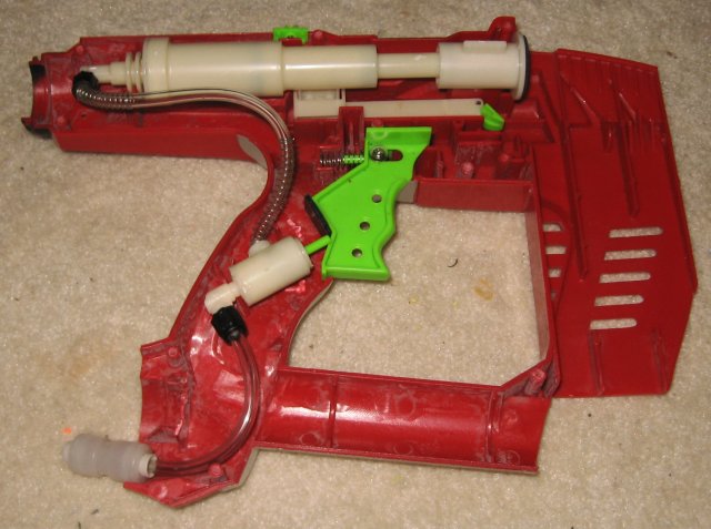

This? http://nerfhaven.com...?showtopic=7433
I didn't really go into detail. I need to take an internal photo, but it's really simple. All you do is chop off the tubing near the bladder and replace it with a straight coupler.
Edit: Here's what the inside of my tank-ready magstrike looks like.
I will be updating the main article with a new schematic option for hooking up a paintball tank directly to air powered new guns. But that will have to wait until I can obtain a new inline regulator.
