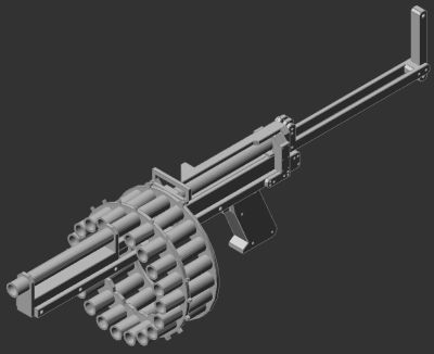

Good grief, I go on spring break, come back, and all sorts of new designs are released. This latest design looks pretty good, but it does kinda have that mini-gun look to it. Maybe a mini-gun combined with a machine pistol... (Shudders at the thought of having one pointed at me)
Keep up the good work, I'd really like to see one of these clean designs come out from the computer into physical form.

Oh, well the design as-is now can be setup in two modes. One where the grip is the priming handle (allowing for prime-and-fire with only one arm) and the other with the stock folded and the side plates changed out so that the grip is stationary and the handles on the side are used for priming. I do however see now that a fore-grip would be more ergonomic as a priming handle so I may ditch the side handles so all that needs to be removed is a pair of plates that lock the grip to the priming action.
I'm also considering a removable barrel attachment for the front that would improve accuracy.
Edited by CaptainSlug, 20 March 2006 - 07:24 PM.
#34 CaptainSlug
Posted 20 March 2006 - 09:02 PM
Here we go. Now all you have to do to lock the grip/trigger so that it's not used to advance/prime is simply move 4 thumbscrews. The added foregrip provides stability when the weapon is held with two hands and the stock is folded onto the top of the gun (or removed).
The removable barrel attaches to the foregrip with 3 thumbscrews and also acts as a clamp seal to hold the drum tightly when the weapon is ready to fire. It will improve accuracy, but will prevent the drum from being able to load stock darts. Therefore it is optional.
Having the removable barrel also allowed me to shorten the length of the drum.
The drum can't be easily ejected with the barrel in place so that seems to be another disadvantage of having it. I'm not sure how to fix that at the moment.

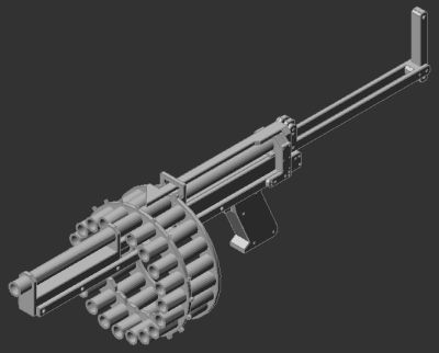

Posted 20 March 2006 - 09:40 PM
I think I've fixed the drum ejection problem.
I widened the clip retention rollers, moved the advancing tooth back a little bit to get it out of the way, and I added a tooth to the underside of the clip eject part so that it pushes the foregrip and barrel forward a little bit. Now the drum is much easier to remove whether the barrel is in place or not.
Edited by CaptainSlug, 20 March 2006 - 09:40 PM.

Wow, you can tell how easy it is to remove the clip from a rendering?
:ph34r:
Official Leader of the Nonsense Brigade
Yes, I'm the Cliff Claven of the Internet.
#38 CaptainSlug
Posted 20 March 2006 - 09:52 PM
:P
Yeah, I've been doing this kind of thing too long. :ph34r:
In effect you will point the gun at the ground, press the clip-eject all the way down with your right hand which will advance the foregrip and barrel 1/4-inch". The drum will drop forward and can be pushed towards the top of the gun a little (either with your left hand or your leg) and it will fall to the ground as it passes over the barrel and foregrip.
Without the barrel attached you should be able to simply dump the drum in the same manner with only one hand used to hold down the clip eject.
It should also be fairly easy to design a straight clip to fit in the same mechanism that's meant to hold the drum.

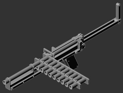

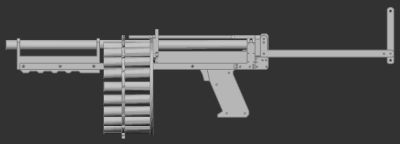

#41 CaptainSlug
Posted 21 March 2006 - 07:08 PM
Huzzah!
Minor edits on the clip retention system were needed to allow the acceptance of both a drum magazine and a straight clip magazine. The changes made will allow a 10-round straight clip magazine to be used in place of the drum.
The straight clip is also extremely easy to feed into the gun, carry on hook straps, and eject by holding down the button and tippin the gun to either side.
Now it kind of looks like a STEN...
Edited by CaptainSlug, 21 March 2006 - 07:16 PM.

#43 Falcon
Falcon
    Velcro'd Beanpole
  • 1,375 posts
Posted 23 March 2006 - 11:17 AM
I've really enjoyed reading through this. Looks like you're reall thought this stuff through.
On the most recent addition, allowig both straight and drum clip acceptance:
You might want to be sure that there's something to hold the straight clips horizontal relative to the gun. Otherwise, they'll get pulled down, and will be hanging at an angle. If you put in any sort of brace to hold them hrizontal, just make sure it's on the top, because putting a straight brace underneath the clip would render the drum clips unuseable. So if you could put some sort of track on top of the gun that could flip up and out of the way for removal of either clip style (sort of like on the variation of the RF20 removable turret mod that I have on my page, with the shell piece duct taped into a hinge).
Just trying to make sure you have ALL of your bases covered.

#45 CaptainSlug
Posted 23 March 2006 - 09:42 PM
The clip is held from the underside by two retention rollers and one on the top. It's not going to go anywhere provided the eject button is clamped shut with enough force by the spring. The rollers work more effectively than a simple track and provided they're spaced correctly they can hold a drum or a straight clip.
A belt system would be rather difficult to make reliable. I'm working on a different design at the moment that uses a huge "gravity clip". I don't really want to release that design yet because that would be "teasing" since I REALLY don't have time to make it right now.
And I don't have plans to make this design in mass quantities, unless it proves dreadfully simple to make. Material costs are quire low since it was designed to be made out of scrap plastic that I can buy for a few dollars per pound.

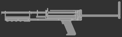

#46 CaptainSlug
Posted 24 March 2006 - 12:12 AM
Final version that has alot of small revisions. Mainly I needed to change the size of the plunger tank, which allowed me to change some things I wanted to previously but couldn't.
Edited by CaptainSlug, 24 March 2006 - 12:14 AM.
