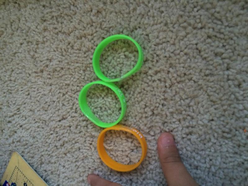

Homemade rings write up
Recently, I thrifted a koosh vortex tornado missing it's sight but with it's original rings for 50 cents. I had 4 rings, but I wanted more(as always) so I made some. Disclaimer: no, this is not my original idea. Someone in the thread on making these from tape suggested using promo bands. This idea was not explored, however, until I did.
Here is a pic of what the rings will look like when you finish.
Picture at bottom
Pretty, right? No? Well, they work.

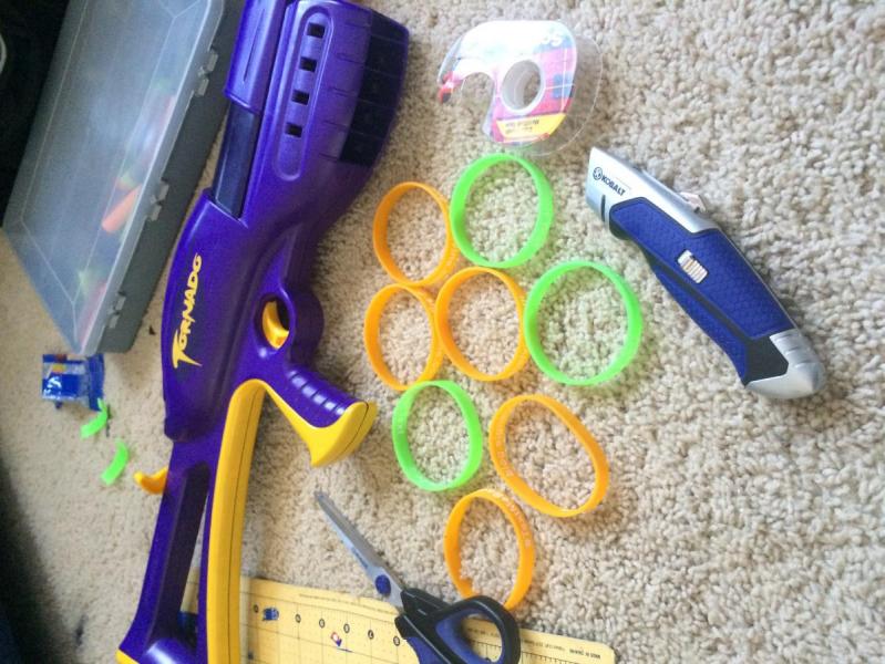

The materials you will need are as follows: Scissors, a measuring tool, rubber bracelets, scotch tape, and a heating tool(heat gun, lighter, stove, hot glue gun tip, etc.).
Pic at bottom
The first step is to cut one horizontally. Nothing too complicated here, just a simple, straight cut will do.
Then, measure and cut the band to ~5.7 inches, or 14 cm. Again, just a simple cut.
The third step is to cut a piece of tape approximately 3 inches, depending on the thickness of your bands. Wrap this around the two ends until you have 3 layers of scotch tape, and make sure it is firmly wrapped so it will stay in place while you heat it. You could stop here, if you want fragile and easily destroyed rings, but you shouldn't.
Finally, use the heating tool on the tape to get it to shrink into itself and really bond the ends together, greatly increasing the durability of your rings. This might take some practice, as the tape likes to shrink very fast.
That's my writeup on my homemade koosh vortex rings for ya. Hope my first topic was a good one. image.jpeg image.jpeg
