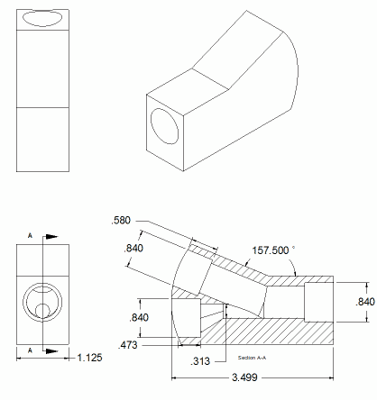

Hey Guys, this is my first post, so any general feedback would be greatly appreciated.
Also, I would like some feedback on my redesign of the 1/2" PVC Wye.
I am planning to take the final design to a plastic injection molding company, and from all the general feedback I have gotten, the general verdict is that people want the wyes to be clear, have a direct connection to 1/2" PVC Couplers (see image below), and have better dart feeding because of a gentler slope and a dart ramp.
This is what my first iteration with the direct connection looked like:
I then went back to my design software and I shortened the wye (to save plastic) and set out to adjust the slope and to construct the dart ramp.
I demoed the new design in this video:
http://www.youtube.com/watch?v=Dva1EPx36Co
Any questions or feedback would be great,
Thanks

Are these made for streamline/elite darts and/or silicone domes? And will these work with them?
Also, don't you think that the way the dart ramp makes a major obstruction in airflow will diminish range?

@Tangerle: I am going to do some more testing with different angles and different ramps...
@DartSlinger: I don't know if my design will feed streamlines or silicone domes, I need to do some more tests with a more powerful blaster.
As long as the hole has a 1/2" diameter its fine since that is the size of darts.
If it doesn't fire silicone domes or steamlines, what is the point? Basically the only darts people use now are slugs, and slugs work just fine in regular wyes.
As long as the hole has a 1/2" diameter its (sic) fine since that is the size of darts.
What I meant is that from a thermodynamics standpoint, the dart ramp is creating a wall in the way of airflow. Some of the air goes immediately through the hole, but the rest slams into the wall, creating energy loss through turbulence, friction and heat before it can be redirected through the hole.
Better feeding. Slugs can get jammed in regular wyes sometimes.
I dont believe those negatives outweigh the downside of having deadspace, although I may be wrong.
If two powerful is a problem then just go with one powerful. I guess this style of hopper will work even beyond three powerful..
Not all people shoot parallel to the ground at all times or make good feeding slugs. These make for usage to be easier and more consistent. Plus, they can be different colors which is totally badass.

The ramp should be solid, Kronos. All the way through, so there is no "wall" for the air to hit. Just like my diagram. I think you know that, though. This was just a prototype to test feeding only.
Very true. Although most of the time those slugs are badly made, and/or the person didn't chamfer their barrel entry enough.
Not all people shoot parallel to the ground at all times.
Well, if you're hunting birds with a BBBB...
Anyway, Your point? With these your hopper will be even less vertical, thus making darts gravity feed slightly less.
Agreed. It would also increase efficiency if the air is funneled.

@Shanaynay: I am looking long term, 500 would sell eventually, most likely after a year or two.
@DartSlinger: I am doing more revisions to the design, this was just a test, and the hole in the dart ramp will not act as a wall in the new design due to a funnel
@mysterio: Could you elaborate on deadspace? I am new to homemades.
@Bchamp22795: Yes the hole will go all the way through, and the hole will funnel in the air.
@Goldie: I can make other couplers, in fact I have been working on a design for a universal coupler that accepts 1/2" PVC and 1/2" CPVC; Thoughts?
Also can someone give me a brief list of commonly used stefans; I know about domes and slugs, but what other types, and what specific types of domes and slugs as well? I want to test as many as I can for reliability in the wye.

I feel your pain on that one. That happened to me a lot when I was an FNG. Hey, I suggest that the moderators make you a Pleb.
Dead space is an unfilled orifice of air in a blaster or similar component such as a barrel or magazine (hopper, RSCB) which steals from the power of the blaster. Think of it this way. You have a SNAPbow with a barrel on the end. Pretty efficient right? Now imagine that right before the barrel, there is a big bulge in your barrel, right behind the dart. Pretty inefficient, right? That big open space will decrease the overall pressure made from your plunger, hence making your SNAPbow have lower range. Another example is this. You have a filled hopper. There is very little air to be compressed except that which is in the plunger tube. Now think of an empty hopper. All that unfilled space in the clip/magazine part of it has to compressed along with the air in the plunger, but there is still the same amount of pressure as there was when the hopper was full, so you get lower range.
I am glad to hear of these revisions. It will make it more efficient.
That sounds very interesting. I would definitely appreciate a coupler where you could just slap a piece of CPVC into it to test fire, instead of having to find a barrel that's been pounded into PVC.

I wouldn't say these are that common. At least here, we all still use metal washers for weights. Its easy and you'd have to be an idiot to mess it up. Exposed metal blah blah blah.
At any rate, I'd say the most common form of darts are Slugs, glue domes, and silicone domes. Perhaps with amiors being in the top 4. You can ignore everything else. Though I'd say if it can feed silicone domes then it shouldn't have a problem feeding anything else.
Also any blaster powerful enough should feed from a 35* angle. If it can then you're using the blaster wrong.
Don't worry about dead space so much. What you're introducing is no more than what a normal wye already goes, and that amount is negligible on any blaster that's able to fire a hopper well (again if dead space is an issue for you, you're doing it wrong). However I feel that the wye should come without the stub. I personally like to make sure my stub is right up against the bushing of my blaster, and that changes depending on the manufacturer. You could keep the ramp, but make it so that you can still plug in 1/2 PVC.

@dartslinger: Being a pleb would be great thanks!
Also the revisions should eliminate the deadspace.
@andtheherois: I have already eliminated most of the deadspace in the design.
Also the nub does raise a very important question. I will ask for a general consensus when/if I make another post.

Is it easy/possible to lower the angle further to help feeding of long darts/stock darts/silicone tips?
What sort of printer do you print these on ? Are you planning on making the files available for others?

@lech, It would require me to redo parts of the design, and I think that the design will be able to feed silicon tips, but I am not sure yet, and it should have an easier time with long darts.
I actually don't know what the printer is called off hand, it is my friends. I have my own, but it prints big things with less detail, whereas his prints small stuff with great detail.

Shallower angles are possible provided that one of the ports in the wye is offset. Realizing this I managed to get down to a 22.5 degree angle.
Going too shallow might lead to clearance issues with other parts of the blaster. Especially on blasters with larger diameter plunger tubes.
