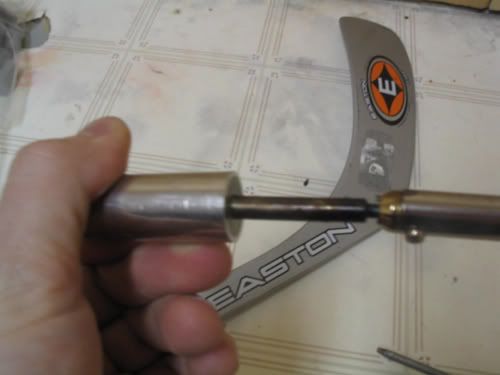

I've been A member of this site for a while But I don't frequent it as much as i used to, I don't play much Nerf anymore either but I do enjoy making things So I decided I would give making Nerf darts A try.
I used the bigger foam backing rod I'm not sure the size right now. The first thing I made was A small Jig that would allow me to both cut the foam square and to the right length.
I used a razor blade to cut it.
I then did the old darts in a Pillowcase trick and put them in the dryer to straighten them out.
Before I had tried to put the glue on the end with the glue gun but it never really turned out really well, So I made a little bullet form on my lathe.
I burned a small hole in the end of the foam so I could put a weight in, I used some steel nuts.
I put some glue In the form very carefully and pushed the foam in as evenly as I could.
For the other end of the dart I made an attachment that went on the end of A soldering iron, I also made a tube with one end that had a smaller hole in it just big enough for the attachment to go into.
When the end gets hot it burns the foam quite quickly so I had to do it very quickly.
The hole came out very nice and is not jagged, although it does have some burned pieces still in the hole they are easily pulled out. Also If you plan on doing this yourself I suggest You do it in a very well ventilated area, It does let off some fumes.
And here it is.
I'll be happy to answer any questions you may have.

The Only gun I have used them with Is my Night finder that I put A new Barrel on and compared to The other darts that I made These Darts Are Fantastic they shoot absolutely straight and a lot further. I Have never measured the ranged but its decent and They really hurt to get shot by.

They shoot further than the other crappier "stefs" that I made they don't curve at all when fired either.

The only thing I put on my Night finder is a new barrel and I've not shot them outside at all but I could take some test shots and measure how far they went.

The problem with a complex dartsmithing procedure is that it takes too long to churn out a large batch of darts. When you spend more time making darts than shooting them at people, the marginal gain of carefully crafted ammo gets dwarfed by the trouble of actually creating them.
So the question is this. From setup to cleanup, How long does it take you to make 100 darts?

I've never actually made a lot of them but if i got right down to it i could churn them out pretty fast, Probably faster than regularly made ammo. I've tried the other ways and they are just too clumsy and the product is very inconsistent.

With jigs and forms to do a fair portion of the work, I don't imagine the darts taking as long to make as people think. When you do more to take the human factor out of the process, things tend to move faster. Hell, with this setup, you could probably make a few simple robots (i.e. mindstorms) automate the process, and turn use it for a capstone project in college. I am an industrial engineering major, and this just got my mind going crazy.
That being said, initial set-up would be a bitch. to mass-produce these darts, a mold capable of putting pits on 10-20 darts at a shot. Machining the metal for the molds would be time-consuming. But if the cutting time goes down to half a second, and you can glue and form 15 darts in as long as it takes one to cool down.
I want to know how long it takes the glue to cool enough to remove the dart from the form. I see that being the biggest time-sink in producing these darts, but that can be remedied with heat-sinks or refrigeration while you wait.

The Jig makes cutting them to length a breeze I could probably cut about 1000 in an hour. The rest is what takes the time. To answer an earlier question the glue begins to harden almost immediately so It doesn't take very long at all, I suppose if I had 3 or 4 bullet forms I could do them quite fast.
