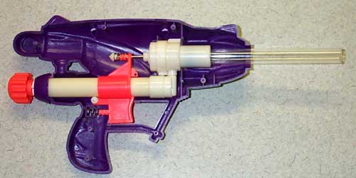

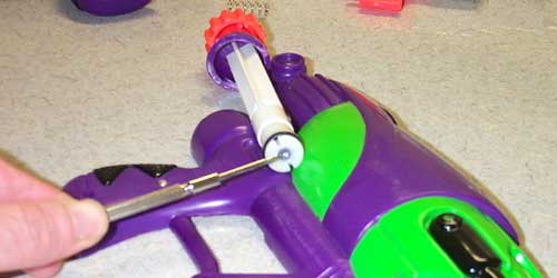

First I opened the gun by carefully prying off the plastic rings around the barrel and the pump tube. After opening it I plugged the overpressure release valve in the pump so as to achieve a higher pressure in the air tank. Simply place a dab of hot glue in the circular opening on the end of the pump tube - make sure it doesn't extend out beyond the plastic. After plugging the valve you will be able to blow your air tank with over-pumping so I'd stick to 3 or 4 pumps max.

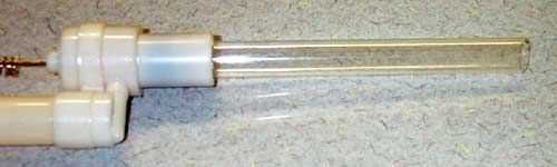

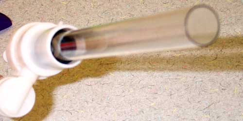

Next I pulled out all the junk from the stock barrel, cut a 6" piece of 1/2" ID PETG tubing, wrapped one end a few times with electrical tape, and jammed it all the way back to the valve in the air tank. Before closing it back up I removed the bottom bar from the trigger guard to make a bit more room for my fingers.

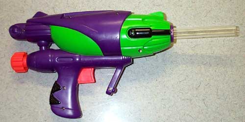

It's really that simple. Shove a properly weighted (3/0 split shot or 1/4" steel slingshot ammo) micro stefan down the barrel and get ready to put the hurt on.
I range tested it with micro stefans, 4 pumps and a level shot on concrete:
long: 91', 1"
short: 73', 10"
Average: 84', 7"
