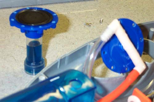

AirTech Liquitron mod:
My goal was to test the effectiveness of the AirTech Liquitron modification. The mod involves draining the tube and punching a hole in the rubber seal so that the tube becomes a secondary air tank. In theory, this should have a small but positive effect on range. I wanted to demonstrate, with a high degree of accuracy, how effective the mod actually is.

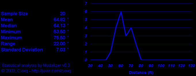

Control: Before the Liquitron Mod

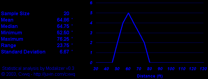

Experimental: After the Liquitron Mod
The data show no evidence of any change at all in the range of the gun. The relatively low (and similar) standard deviations and clean histograms indicate consistent procedures. The nearly identical mean, median, and range make it clear that this mod is not an effective way to enhance range.
