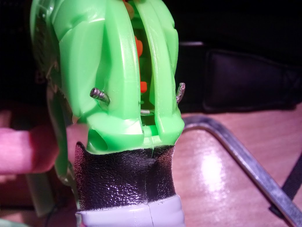

3. drill 2 holes near the back of the blaster. one on each side. The ideal location is where the hammer seemed to be at it's best position for priming without over-priming. This is a little touchy, and not an exact science, which is why you see that my nail is bent. I recommend drilling a little further up the blaster so you have room to adjust back by bending the nail.
Here you can see the end of the nail with glue. the nail goes all the way through to the other side.
4. Insert the nail through the holes and try to prime the hammer with 2 darts loaded. You may find that your hammer cannot go far back enough to prime. THAT'S OK! just take the nail out, bent it a little, and re-inserted it through the holes. repeat this process until you're able to prime the hammer without OVER-priming and letting air escape.
5. Once you're sure you've found the perfect nail-bending position, glue it so It doesn't fall out. Let the glue dry in the primed position. so it glues at the right angle.

So, after extensive use, I have good news and bad new,
the GOOD news: I never once even came close to scratching my thumb on the nail. I don't even come close to it. I hammered down the point so much that I'm pretty sure drawing blood is impossible.
the BAD news: I need to re-adjust the nail. sometimes my trigger gets stuck while priming. lame. but fixable.
