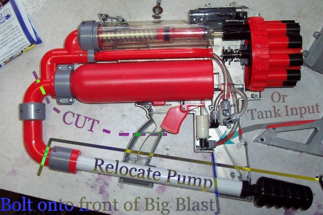

What if you took 2 magstrikes with kbarker's PETG mod, and bolted 'em on the side of the Big Blast with your coupler mod, would it be pretty heavy? Or should I just try to make a Bob Ii???
And also, if I made the Bob Ii, how would you make the RF20 pump work with the backpack, I'm not that expeierence (sp) with modding to know :(. Or could I just make the RF20 pump on the side of it?

Well you could relocate the pump to the side. If you don't want to have to replace the stock trigger valve or hook it up to a tank the RF20 has to be mounted a bit lower so that the bladder compartment clears the grip on the big blast.
Image borrowed from elsewhere because I didn't take a picture of the stock internal configuration. If you couldn't already tell the only stock parts left in my RF20 is the piston assembly and the red tube piece that keeps the piston assembly in the correct position.
The tank allows me to ditch the bladder altogether. You can hook the tank directly up to the stock trigger valve. Or like me you can just ditch the stock trigger valve and use a valve of your choice to go inbetween the tank and the air line to the piston mechanism in the RF20.
You can do the same with a magstrike by bolting it to the side of another gun. And a minimized magstrike is a bit lighter than a minimized RF20. But the end result would probably be less ergonomic.

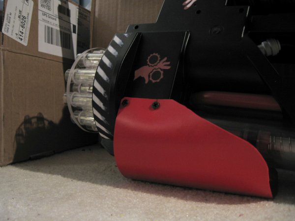

I caved and decided to buy paint. Then Bob went all goth on me.
