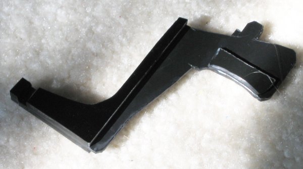

If you plug the pump of your Big Blast and that results in your trigger breaking it's not really that difficult to make a new one. I made this one in in 30 minutes using 1/16" ABS plastic sheet with a layer of 1/8" acrylic on either side to add the slides and trigger pin hook.
#50 Dayko
Dayko
  • 1,037 posts
Posted 11 June 2007 - 06:57 PM
What doe's plugging the pump do? Nice trigger CS.
