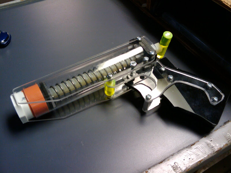

A +bow I made for a member at the Revolution.
A day late and a dollar short but I also cushioned the plunger head in an effort to silence and increase durability.

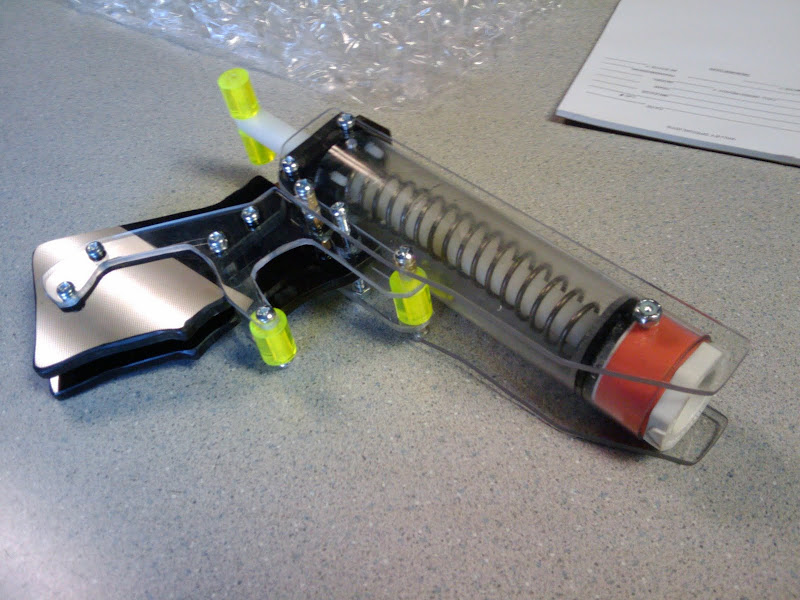

Latest variation of the LpL design, in which I have added an extra support in the front, and changed the polycarbonate plunger rod out for a stronger 3/8" square nylon rod. Definitely stronger, you don't feel like it might break when you prime it. There doesn't appear to be much, if any, performance hit from the extra mass. Also, any of you guys who build one of these? DO NOT predrill the hole at the front of the plunger. Wait until you have everything else built, and then drill through the whole thing at once. Also, there is no reason to use 6.5" of tubing. You can save material by just using 6". I've found that with 6.5", the spring will shorten slightly over time, and you won't get full extension. Plus, the longer plunger rod has more mass, and doesn't accelerate as quickly.

I really like the colors on that LpL...
