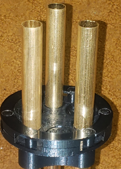

this is a long time project that has sat in my cad design phase for the better part of 6 years, with all the free time now applicable to me
i finally decided to bring the concept to life
this build is based on the real world Gau-19 ,
the reason i have chosen this is from the limitation of rotating air chambers adding extra chambers increases space by a lot, three barrels is the easiest to work with.
this gun's internals for air chamber is based off the Nerf Long shot as dimensions are easy to attain online with out gutting my first edition, and working components are cheap and easy to effectively acquire. {springs,seals}
this will be a DC powered device that uses air pressure to launch darts.
 a work in progress and this post is where i am at with the build so far.
Barrel:

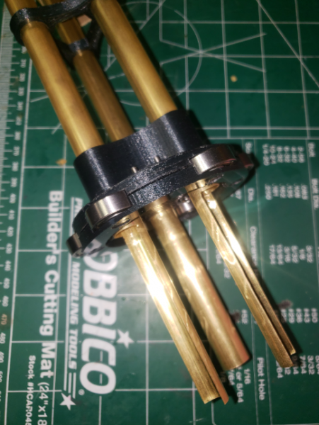

Bearing Races:

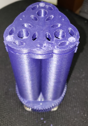

Air Chamber:

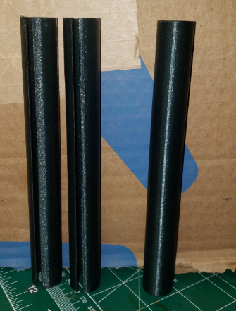

Are you printing the plunger tubes? Did you insert anything in them to serve as the tube itself, or are you expecting the printed surface to work?
yes its these: http://nerfhaven.com...-1586739115.png
 - no i do not have anything inserted into them atm, they are water tight and hold air pressure: if they do fail then ill looking at acquiring aluminum inserts for the Nerf long shot and install 3, or custom fab them from aluminum tubing depending on whats easier to acquire and cost
      what i am planning on doing is  using a 36MM ring slightly heated and pressed through the tubes to fix the uneven internal surface caused by printing
 after fixing the internal surface to smooth  then i expect them to function to a point:  surface friction if it exceeds 180 C will deform them --  mitigation by slowing the rotational speed down and sufficient air flow
I'm less worried about pressure/airtightness at these low pressures than I am about smoothness. I'd recommend using some tubing stock - aluminum like you mentioned, or polycarbonate, or PETG, or something.
