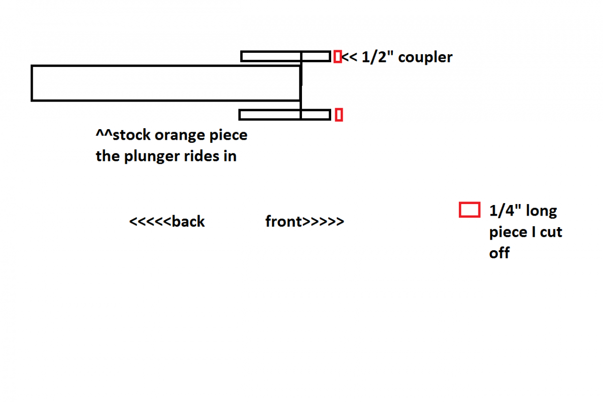

This diagram should explain it. I threw the 1/4" long piece away. The ridge is resting against the orange piece and prevents the coupler from sliding backwards.
Edited by The2ndBluesBro, 22 June 2016 - 07:50 PM.
#18 Vexal
Vexal
  • 68 posts
Posted 22 June 2016 - 08:25 PM
Here is what I interpreted from your diagram. Let me know if I got this right or not. http://imgur.com/SZgQeLj

Dude trust me, I studied that guide. And it's well done. And I see what it looks like, but 2ndBluesBro is showing me a different way about how it's done, which I think is the same thing as yours but with excess pipe
Yes that's what I did. There's not much difference between the two ways of doing it.
