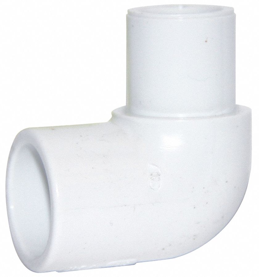

Looks nice! Kind of off topic, but for the RSCB, I highly recommend using a "street" elbow or tee, which reduces deadspace by a sizable amount and looks MUCH cleaner. This is what I'm talking about, it might be officially called something else.
Thanks...good to know, I don't use RSCB's, and they are kind of out of date anyway, but I like the style. Would probably be a bit more relevant for "the chopper".
