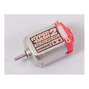

Is it this one?

Is it this one?
I don't think so, mainly because the Taimya plasma dash motors are brushless, and that motor isn't. Here is the one I belive he is talking about:
Edited by hamoidar, 18 October 2012 - 02:25 PM.

Is there a way to tell if a motor is brushless from the picture alone?
Well, sort of. The motor in the picture you posted is a pretty standard brushed design. Brushed motors typically have a flattish plastic end cap with leads on either side or the top of the motor.
While brushless motors either have a different end-cap which is thinner because of the absence of brushes(such as the one above), or, the shell of the motor, which has a permanent magnet ring inside, rotates around the stator coil. The second type is typically used in hobby helicopters and other hobby flying devices. Note: I'm not sure if it's called a stator coil in brushless motors, please correct me if I'm wrong.
