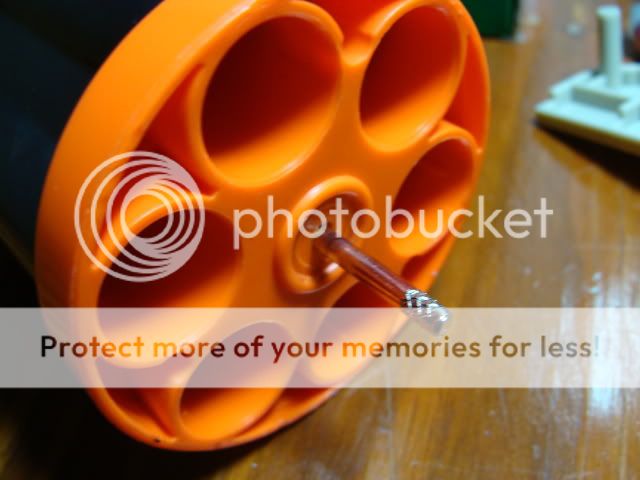

Take this rod, glue into the turret like so:
not like this (the turret will not fit):

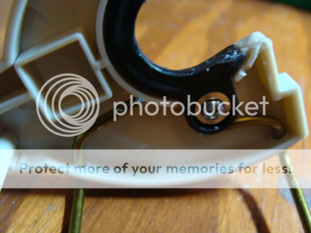

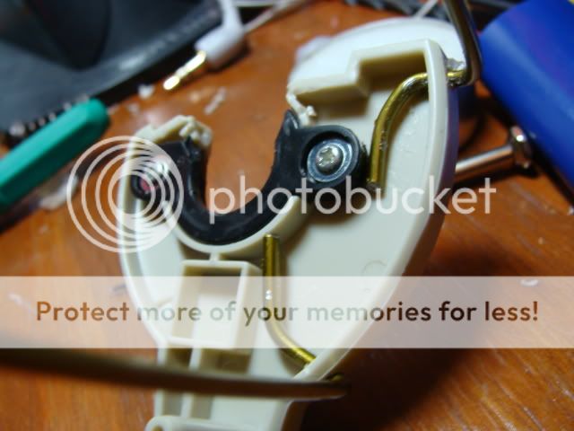

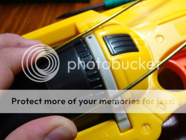

Now take the coat hanger and straighten it and put it into this gray piece, and secure with hot glue (ensure it's flush with the plastic:

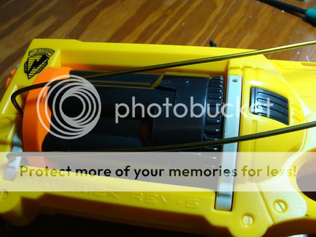

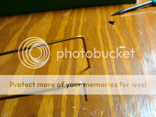

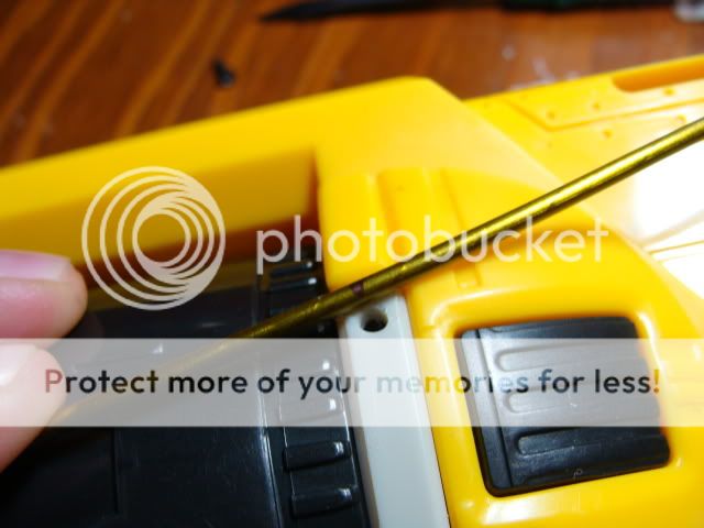

place everything together in the shell and bend the wires to holes on the other gray piece, mark the points to bend them in, with a marker:
disassemble and bend away. It doesn't have be perfect when you glue it in, the wire will bend after glue Has dried.

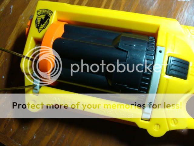

Align the gray pieces and reassemble:
DONE!!!
Time to do actual mod: 30min
Modding, dancing and screwing up: 1.5 hrs

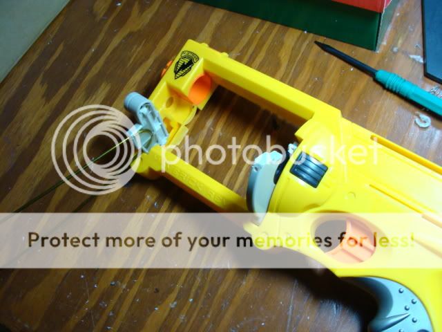

Now the turret will pop out from the rear,
To insert the Turret:
front end in first:
Snap the back into place:
The mod does nothing for range, only for the ability to swap out the turret
