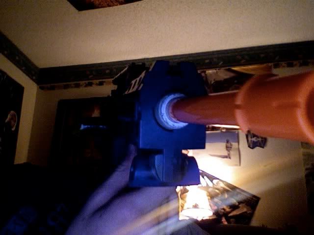

Posted 03 April 2008 - 08:00 PM
Well you don't have too but I think it looks cool and i like it but sure you could probably just cut the barrel off instead of the whole gun.
This is what the front looks like as of right now.
I took the orange muzzle off and wrapped 3/4 PVC in duct tape until it was snug.
tcambre on IRC.
<3

Have you already done the mod? or is that just cosmetic stuff right now?
#41 sputnik
sputnik
  • 911 posts
Posted 03 April 2008 - 08:05 PM
No, not yet.
I did that last night, because I wanted the extended barrel and didn't feel like sanding out the muzzle.
So from there, would I need to cut the front off?
Also, the CPVC fits inside the stock barrel, right?
Edited by sputnik, 03 April 2008 - 08:09 PM.
