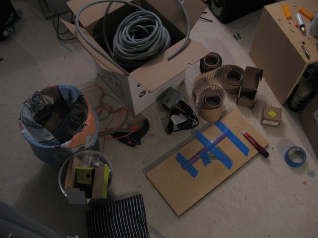

Supplies
+ The felt disc stickers - part# 8771K22 = 500 pieces for $5.89 Also available in green, brown, and black
+ #8-32 washers - part# 91083A009 = 585 pieces for $4.59

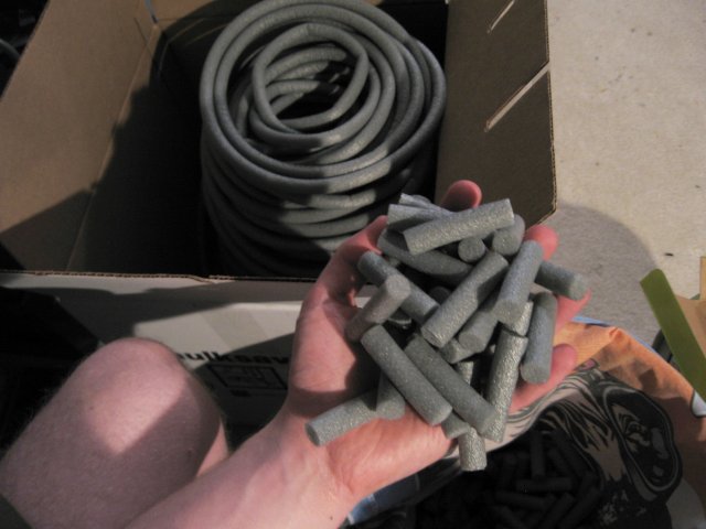

+ A ton of foam backer rod in the size you prefer (mcmaster part# 93295K43 for 250 feet of 1/2" OD)
+ Carpenter's Square or Two rulers
+ Painter's Tape
+ SHARP Box Cutter (Utility Knife)
+ Slab of wood or a cutting board
+ Hair Dryer
+ Pillow Case
+ Two waste baskets or buckets
+ Hot Glue Gun or Liquid Nails

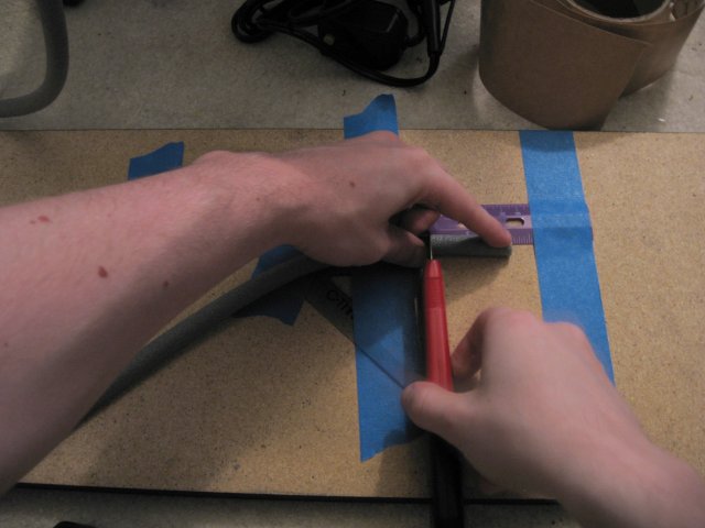

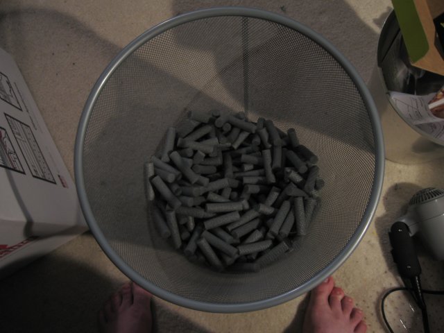

1. Tape the carpenter's square or rulers to the cutting surface that that you have a perpendicular measure setup at whatever length you intend to cut your darts to.

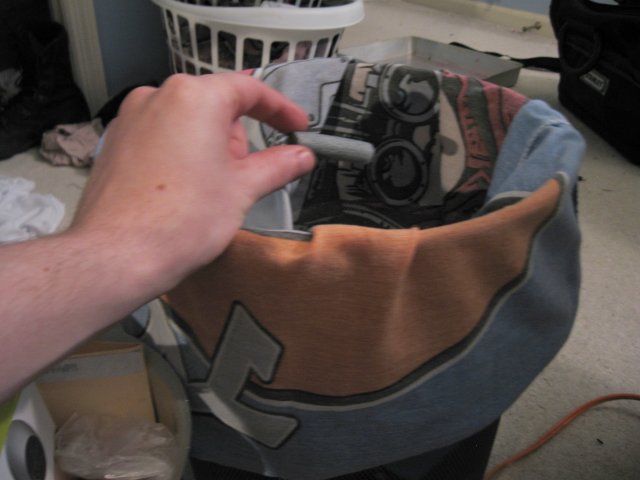

2. Line one of the waste baskets with the pillow case.
3. Squarely cut the very end of your roll of foam using the Utility Knife.
4. Squarely cut the foam to the dart length desired using the Utility Knife while the foam is squared properly using the rulers.
5. Drop the blank into the pillow case
6. Repeat steps 4 & 5 until you run out of foam, or the pillowcase is half full, or you die of boredom. Whichever comes first.

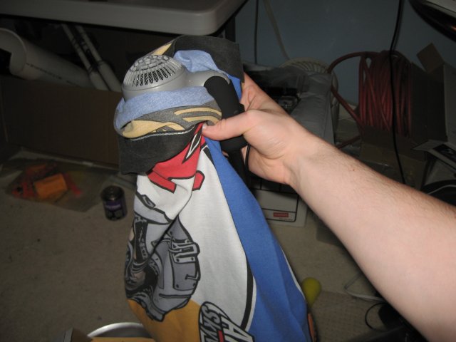

7. Fold up the open end of the pillowcase onto the hair dryer and turn it on low.
8. Smack the bottom of the pillowcase repeatedly so that you can mix the darts around so that they heat evenly.
9. After doing the above for 30 seconds to 1 minute check the dart blanks to see if their texture and sheen are uniform and that they are all straightened. If they are uneven or there are still a few curved blanks repeat steps 7 & 8 until they are consistent.

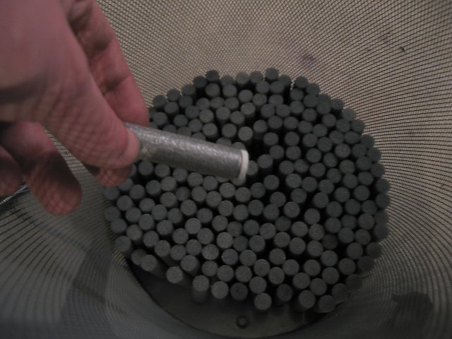

10. Empty the pillow case into the wastebasket. If you still have more foam left and are not tired of cutting blanks you can repeat steps 4 through 10.

12. Peel an adhesive-backed felt dot off of the roll and attach a #8-32 washer to the center of it.
13. Fill the center of the washer with hot glue, or coat the end of a foam blank with a thin layer of liquid nails.
14. Slowly mate the dart blank with the felt-dot and washer.
15. Clean any excess glue off of the edges using your finger.
16. Place the new dart face-down in the empty waste basket.
17. Repeat steps 12 through 16 until you run out of supplies or (again) die of boredom.
