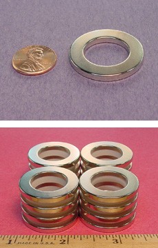

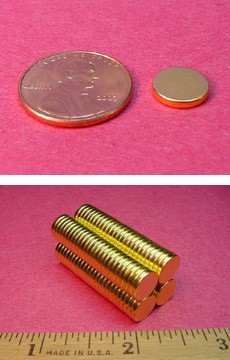

You'd probably have to use something like this (60 lbs of pull each):
Around the plunger shaft inside the tube, and where that's not feasible, you could just arrange some of these (8 lbs of pull each):
lined up around the shaft, glued on.
