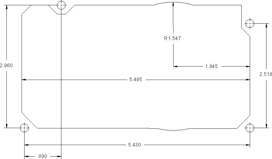

There are many different power supply form factors. TFX12V, SFX, ATX, ATX 2.0 (24-pin ATX with different connector requirements), 2U, 1U, LFX, CFX, and proprietary crap.
Here are the mounting dimensions for ATX and ATX 2.0 power supplies.
http://www.captainsl...modding/psu.gif
Any power supplies made for the ATX specification should have that hole pattern.
For more information on form factors see http://www.formfactors.org
