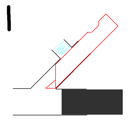

Edit: Simpler trigger design (the light blue is air):
Edited by Paragon, 29 June 2006 - 04:24 PM.

Firstly I think you should stop trying to ram-load the dart into the barrel. That's where most of your mechanical complications are taking place. If you could instead focus on turning each belt link into a sealable part of the barrel you could simply your system greatly. Keep-It-Simple-&-Stupid is the way to go and if you can even unify the mechanism of advancing the belt with the one required to time the firing you'll be much closer to having a feasible design.
Captain Slug is already working on his "minigun" themed blaster, and can tell you that it probably took a bit more resources than he anticipated. A project of that caliber requires a whole lot of extra financial and technological latitude to allow for errors and discrepancies that always occur between concept plans and workable product.
And machining skill can't be overlooked. Especially when you're trying to get several moving parts to work in unison to perform a single operation cycle repeatedly without failing from wear. Just finding the time top make the intricate parts is proving difficult for me right now.
Your current plan is not mechanically graceful because each stage was interrupting the function of the other stages so your rate of fire would be pretty slow in comparison to a manual cycle. Plus you can't find solenoids with enough travel length to push a dart that far and other options would do it too slowly.
The other problem with belt-fed is that you have to load such a large number of darts in advance, and make a consistently dimensioned belt.
I can think of several way to accomplish a belt-fed compressor powered machine gun. But it's still far more complicated than even I would care to undertake because it would require servo timings or complicated valve systems.

The biggest problem I see with your trigger designs (both of them, actually) is that they rely upon a full pull of the trigger to seal the action. In your revised trigger action, there will still be a time period where the air will be allowed to escape, but your trigger action will not be completely sealed against the bottom of your barrel...during which you'll lose pressure. The problem would be reduced by a fast (and hard) pull on the trigger....not something desirable in a trigger action.
