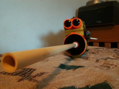

Here is the deal, I was at Walmart a week ago, and I saw the Lazer tag Master Blaster Gun on the other aisle of nerf. Basically, the gun is a Lazer gun with a Lazer rocket on it. I looked at the price and it was 50$ and I shreaked "Are you kidding me I can get that on Ebay For like 20 bucks!". So I went home looked on Ebay found it for 25$, and I bought it. Finally, it came in the mail and once I got it I opened it up, and took out every wire in the gun. next, I did a basic coupler mod to increase ROF. Well, here are the pics of the mod, enjoy
The box
Internals of gun, orginal was just that orange part, and a whole bunch of wires I had to rip out.
Look how big that tank is!
Trigger Sytem, Pull Back that big green handle.
Stock/pump handle. Oragne sliding part changes the stock/pump when you move it to the right.
Wood part, makes gun sturdy.
Overall gun
I Have not tested the ranges, but I think it will easily get 100ft or more. Later, I am going to make an intergration somewhere. Any questions, comments Ideas. Also I think I am the first to mod this gun what should I call it?

The Titans air tank look to be a little bigger, but not by much. The firing pin pull out a good inch or so. Yes, you can bic pen mod it. I have not tested the ranges because I am busy looking for an Aitech. I will post again in like a week because I am busy with drivers ed.

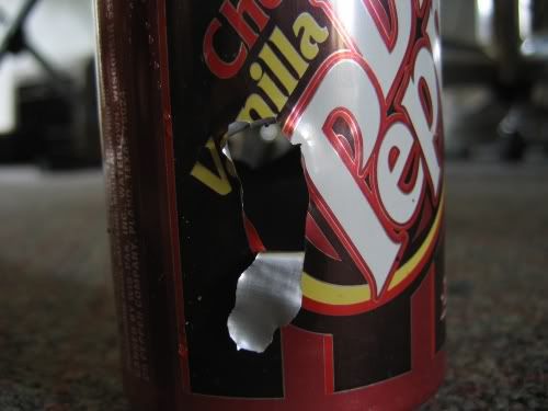

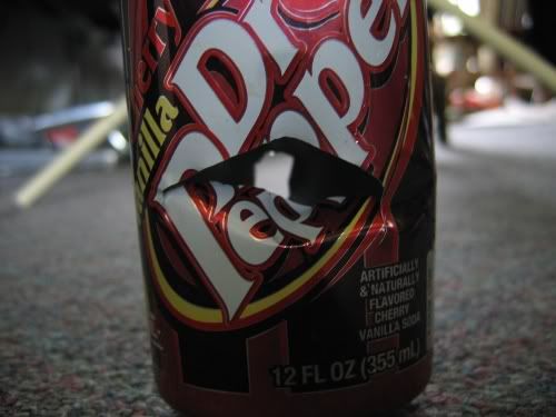

I bought one of these badboys a few weeks ago. I was going to hold off posting anything until later, but here's what I did:
I think this thing can hit 200' easily. I haven't measured the distance but look what it can do to a pop can:
Straight through it.
I have a recommendation for anyone who wants to buy this gun. Get it! This is the most powerful thing I have ever seen. My friend and I each bought one and modded them. We primed them about 30 times and after a few rounds, the valves behind the pump blew. We were dissapointed because these things were extremely powerful, but fragile.

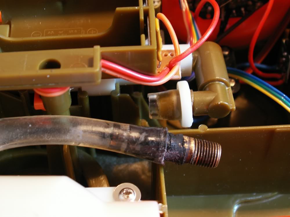

I fixed this with a bike pump. I spliced the vinyl tubing and fitted it with a bike valve. Then I equipped the dual action bike pump and it now is primed 10 times as apposed to 30.

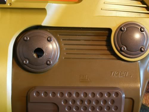

Sure, no problem. This is a picture of the internal splice. All I did was cut the tubing and loctite the bike valve in:
This is the hole I drilled in the side for the bike valve to come out of:
Next, take the bike valve and push it out of the hole. You may want to anchor the valve in the hole so it won't slide out. I also screwed the pump holder on the side of the gun. The pump is removable once you pump the air in the gun. I prefer just to keep it held on the side:
A pic of the modification:
And the final one:
The barrel consists of 1/2" cpvc pressed into 1/2" pvc and pressed into another layer of pvc. Next, I lathed the outside pvc down so it would nest in the orange barrel. I get the full power out of the gun as opposed to a coupler mod.
Bike pumps work wonders in any pump gun. It cuts down the pumping by about 1/3 with a good pump and you can completely bypass most of the valve systems. Imagine a 2k that is ready in one or two pumps! The bike pump I bought was about $22 and pumps both ways for double the output supposedly. The handle drops down into a T handle and is comfortable to pump. 10 pumps later and you've got one bad machine!
