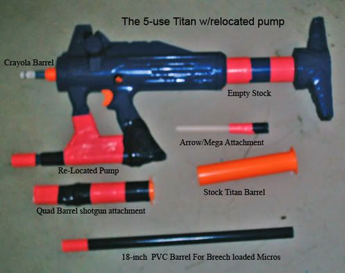

#6 baghead
baghead
    Cheetos
  • 1,366 posts
Posted 24 February 2006 - 02:16 PM
Mattf, on Feb 23 2006, 05:37 PM, said:
I've dug around, and it seems that the answer is no. I'd like to play around with it without having to destroy the stock barrel. At first I was doubtful that Hasbro would create their own threading for this, but after looking around at Lowe's, it seems they have.
Has anyone found anything? Couldn't find a size for it. I know most people attach odds and ends INTO the stock barrel, but I'd rather not mess with it...
Matt
I Did.
The Five-use Titan!
I have two stock titan barrels, one is shotgunmodded using a 2k turret and the other has it's air restrictosrs removed.
bags
Edited by baghead, 24 February 2006 - 02:39 PM.

#13 baghead
baghead
    Cheetos
  • 1,366 posts
Posted 27 February 2006 - 10:03 PM
Mattf, on Feb 25 2006, 06:27 PM, said:
Baghead, I saw your thread earlier. Where did you happen to get a second stock barrel? That would do it for me.
Lots of folks mod their titans so that they don't use the stock barrel anymore, I bought mine from Nerf monkey like half a year ago. try the trading forums i bet someone has an extra one lying around.
-bags
