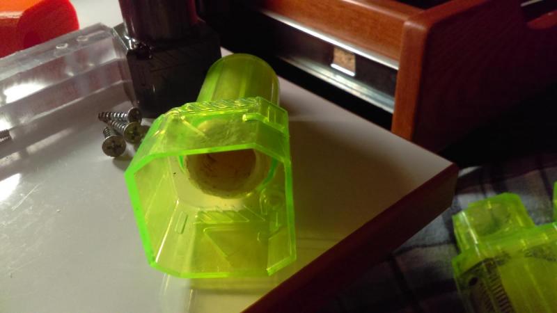

Wrap packing tape around a suitably-sized stub of 1/2" pvc and cram it down the stock piece thing. It provides a guide for the piston rod.

Thank you both for your suggestions, I wound up using the one from Blitz. I am keeping your idea for a later project Duke.
