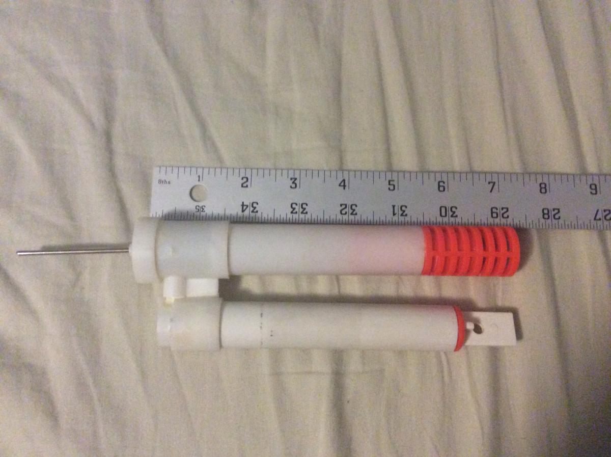

So i will get right to the problem i currently have with my supermaxx 500. The tank is fine as far as i know, but the pump is furiously shattered on the inside. I do not want to try to salvage the tank and pump because i am not experienced in how to fix it yet, so that's going into the parts bin.
What i currently need help with is trying to find a new air tank that could fit into the blaster. Preferably a air tank that is connected to the pump, but if you have proof of some other tank configuration that could work, then that would be helpful.

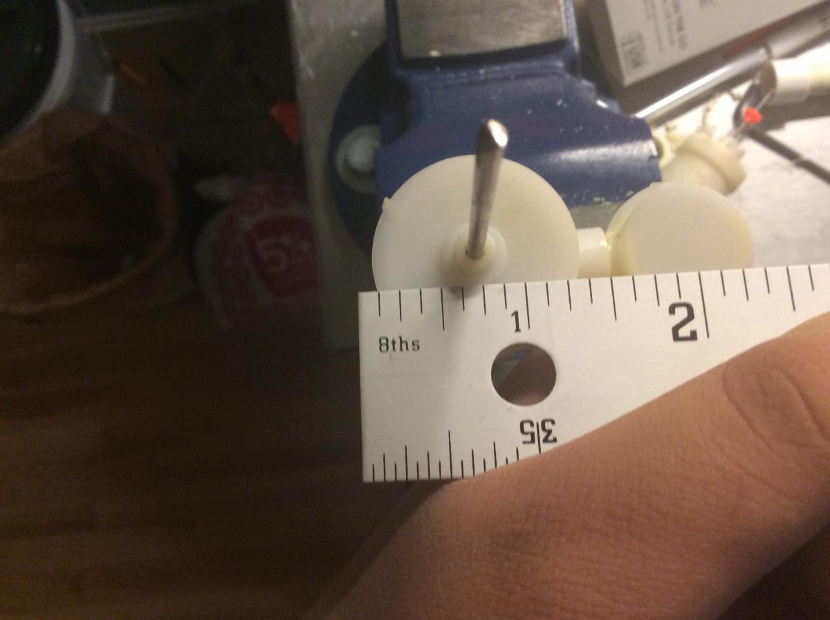

Here is the thing about the SM500. There is NO spare room where the pump and tank sits. No wiggle room, no space for anything that i currently have. List of tanks that i have verified don't fit:
AT3k
AT2k
Anything bigger than an AT2K tank will NOT fit without shell modification, which i want to keep to a minimum.
I have measurements of the tank and pump and barrel in the form of pictures (sorry for low picture quality, only got an ipad to take pictures currently). *Measured in inches*
So far i have asked bobololo for help on this in october which led to me buying a AT2K pump off ebay, which as i previously stated didn't fit.
My thoughts are that maybe a panther tank (if minimized) could maybe work, but i cant find measurements of panther internals. Maybe that pocket shot or whatever it was called from N-Strike could work, but that thing is not nearly powerful enough for me.
Thank you in advance,
Silly.

One of the new, small Panther tanks may fit in the shell, but it will be nowhere near as powerful as the the SM500 tank itself, which as an enormous dump valve. Unfortunately, it also looks like the firing mechanism with the cam on the pin was destroyed, but it would still be good for you to use the stock tank.
I had a pump failure at the check valve on one of my 500s and I cut the pump tube off at the joint, and replaced it with an AirTech 2000 pump tube. If you have an AT2K pump, you might be able to do the same thing; it was a pretty straightforward swap and if you cut a little bit off the AT2K pump shaft, you can fit the 500's pump handle onto it.

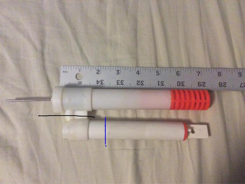

And Ice, the firing stick that is pulled to fire was rusted and broken beyond repair above where i had to cut it. I made sure that it still reaches the trigger, so it will still function if the pump is replaced and the stock tank used.
Finally, as far as i understand i cut on the black line and cram the 2k pump in? Or is it the blue line where i cut?
Yeah, cut it on the black line. You can use a hobby knife or something to carve out some extra plastic out of the hole that will remain and you should be able to make a pretty easy connection to the AT2K pump that way. I would recommend cutting along the black line as close to the pump as possible, so it gives you extra space on the bottom of the tank.
Tetrastrike tanks are probably worse than the small Panther tanks because they can take higher pressures and have a larger dump valve in the front. Plus, it's hard to separate Tetrastrike tanks since they come molded together.

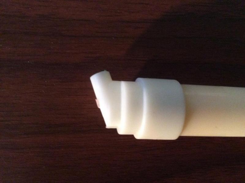

I have attached tubing to the tank, and now i am working on how to attach the tubing to the pump, since it is broken at the tubing attachment point, with no nipple to put the tube onto. I think i can make it work somehow, but i may just need to get a new 2k pump (or other pump, i think a 3k pump may work)
An AT3K pump is too wide to fit in the 500 shell. The AT2K pump tube will fit pretty much perfectly where the stock tank was located.
As far as attaching vinyl tubing goes, you could probably use a hobby knife or something to slowly open up the place where the tubing nipple broke off. Just be careful and maybe wash it out afterwards, since you don't want plastic shards in your check valve. It's definitely better to use vinyl tubing since you can get a better seal than attempting to bridge stiff plastic and it's more flexible in case you need to work on the pump or tank separately.

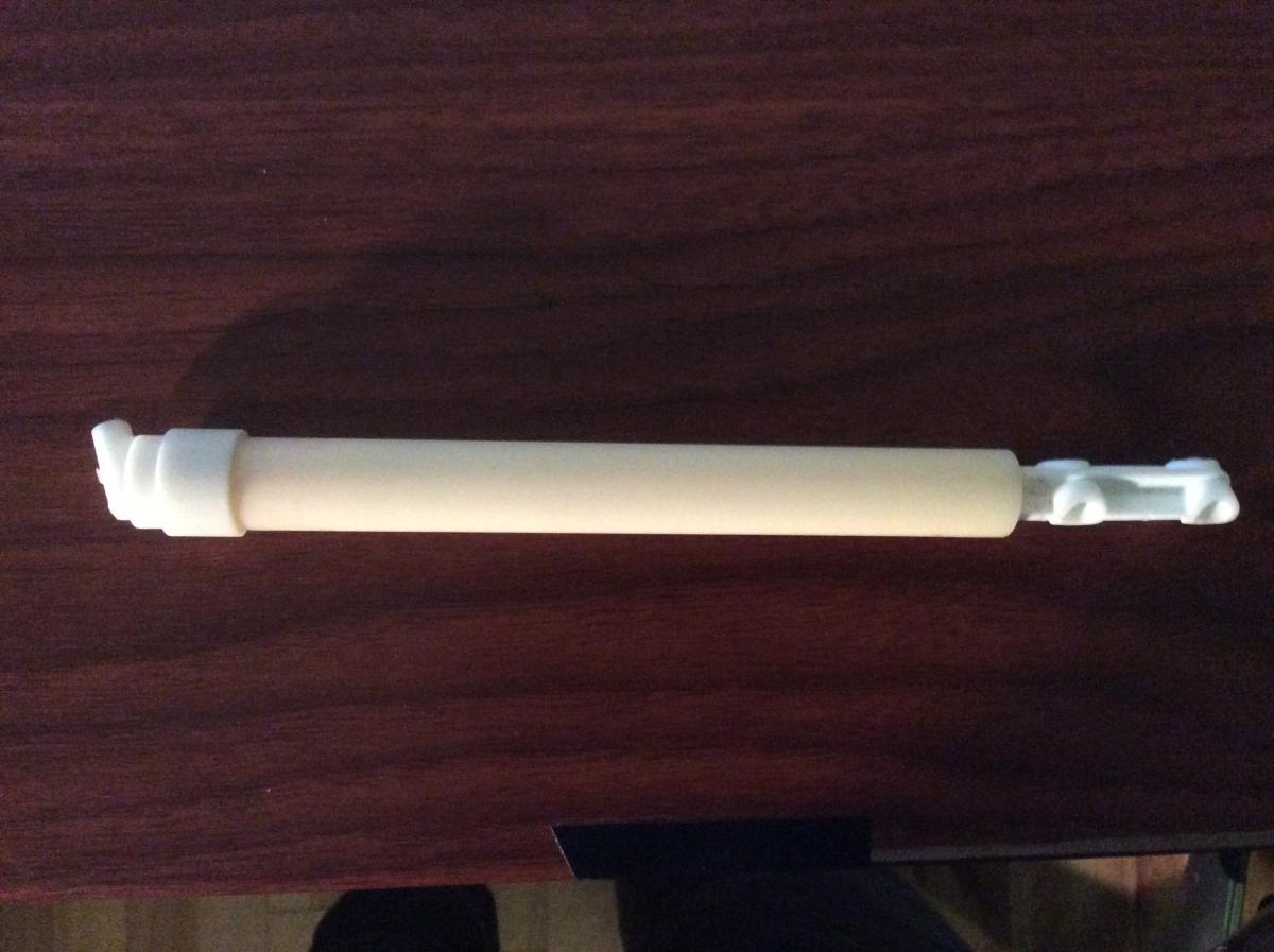

Update: I found that the SM3000 pump is perfect for this application if you sand down the tube connection like shown in the pictures.
Now all I need to do is secure it to the tank!
