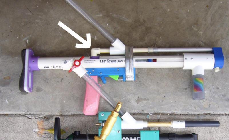

I know I've seen this done somewhere before, but I'm not sure to what extent. That pic is of a homemade PT in a blaster that is, essentially, a PT with a trigger. I thought someone had put a SNAP/rainbow into a L-shot for sure, but I can't find pics of that.

Not technically true. If you took an ESLT, for example, and replaced the CPVC 90-degree bend with a tee and used that as the upper half of an RSCB, it would work.
There have been lots of homemades in blaster shells (e.g. tons of Crossbows, tons of Nite Finders, Tornadobows, Zorn's FAL in the Super Soaker Tornado Blast), but Shmmee is largely right, especially if you're going with a tubes-in-tubes design (maybe excluding Zorn's Fallopian blasters). I agree that a Deploy would probably be a good choice if you wanted to maintain pump-action or a bullpup configuration, but for the most part the easiest thing to do is to put a +bow-style core into a Nerf shell, since those fit into more tubes.
I have done exactly this with my RainbowPup, and it works very well.

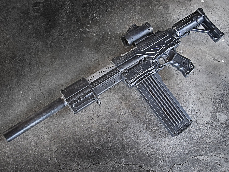

I'll probly end up doing the carbine. While I do have access to a 3d printer the Rainbowpup and ESLT need it more than I'd like to get into for this project. The main reason for wanting the bullpup design was so I didn't have loads of extra barrel out the front but I think I can work around that. Could also do the pump snap but not sure if I wanna try and get the Alpha Trooper's pump working with that.
I'm pretty sure 1-1/4 tube will fit in the Alpha Trooper. I was already planning on gutting the inside. I like doing things the hard way.
The first pick is what I'm going for the second is the internals, the lower one being the AT. I also have a deploy to work with too. I have a longshot, would way rather a longstrike though.

please please please please PLEASE don't do anything flat noob black.
Tactical stuff is very borderline, and not good. Today in Austrailia MakeTestBattle just got their swat on them, and tactical stuff isn't looked on too great in the hobby for that reason.
That being said, if you have a 3D printer you can 3D print a rainbow mech, (literally you can print most of it, I saw it last week at NENO 15) The carbine or any other snap variant is great if you're gonna do full homemade from DIY sort of materials.
To add onto the 1-1/4 in part, that can house inside an Alpha trooper with enough gutting, but you also need to factor in if you're making it pump action and how would you connect that. In the 1st pic, I think that's 1-1/4 in as a barrel extension so you know. Just work on building a homemade first, and make it work without fitting because there's more places to go wrong or mess up putting them into a shell.
Agreed. Don't do that. It's really for your safety more than anything: bright colors help tell everyone around you THIS IS A TOY and prevent the cops getting called.
