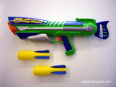

Spud, there is the one you are talking about (Lego Atlantis Harpoon Blaster) and there is a green with blue accents one. The second is the most common, IIRC., however it's difficult to tell because with this color scheme, gen 1 and 2 look very similar.  big+blast.JPG
