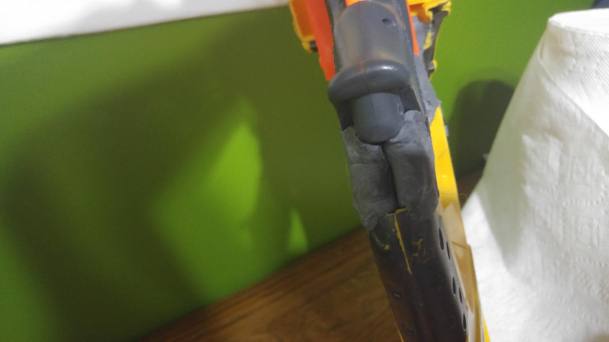

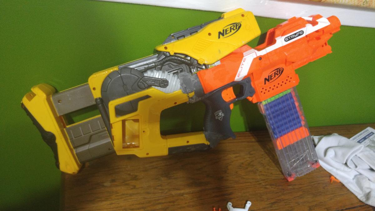

Post a picture? We can't really help you unless we can see how much there is already. But a good rule is to use it until it both feels solid and looks good, make sure to sand it really smooth. Your paintjob will be better for it. Also, those colors sound good to me, but just do what what you want. If you like it, make it.

Yes a picture from both sides would be ideal.
#6
Posted 22 January 2016 - 09:05 PM
Oh, I understand. Do each side seperately and sand down the e putty so the halves fit together. And make sure you're using other adhesives as well, e putty isn't the best for holding an integration together, although it's great for filling in gaps and adding a bit of structural integrity.

you have been lied to
1: epoxy putty is perfectly fine for holding integrations together, you just need to make sure the surfaces are prepared well. give the areas a rough sanding for the putty to grab onto, maybe glue any parts that are touching with a strong epoxy first and you're done.
2: those cutting boards are not very strong at all
#12
Posted 23 January 2016 - 09:07 AM
If I may defend my opinion:1. maybe glue any parts that are touching with a strong epoxy first and you're done.
1. suggesting to glue the parts together with epoxy first proves my point. The absolute best way, however, is to also fill the inside with smoothcast 65d or pour in a cheap epoxy to create a lot of bonding area. However, if you are on a budget, you are correct in saying it will hold. I just don't believe it will be as solid as with more adhesives.
2. I said in my post that it isn't suited for the same jobs as polycarb but its fine for handles, reinforcement pieces and possibly spring rests depending on the thickness. It's good for the amount you pay, anyway.
