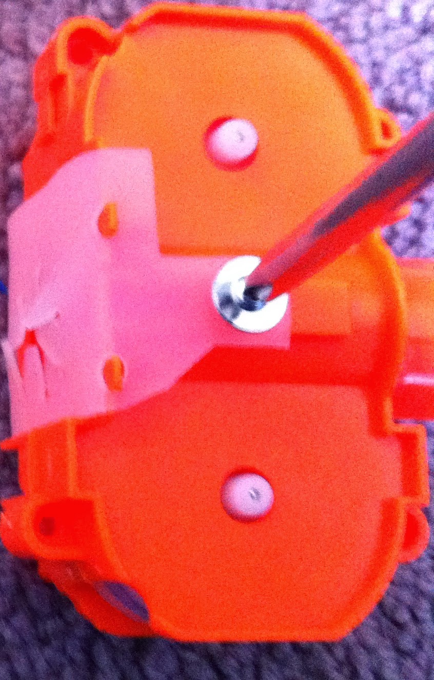

FYI, the jamming might just be because your son isn't revving the motors long enough before pulling the trigger. Could also be the piece of rubber shown here (the "skirt" that others have mentioned)
