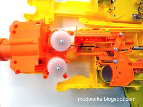

#9 J-Andy
J-Andy
  • 13 posts
  • Location:yes
  • State:Ohio
Posted 12 January 2015 - 10:39 PM
Motors are tricky. You need a balance of torque, RPM, and cost efficiency. It is just a nightmare to dig up specs on some motors. It also depends on how deep your pockets are. There are 180 size motors used for slot cars that will turn 100,000 RPM's but probably get hot as lava and some can run well over $200 a pop. I would imagine plastic flywheels turning at hellish speeds on a hot motor will probably either melt or fly off the shaft causing major damage but I haven't investigated that.
This place has a lot of motors but there are tons of choices all over. I just happen to like this spot because they give you torque and RPM specs at least.
As far as grip... you can probably devise ridiculous grip fairly simply but the down side is you are going to chew darts up.
Try Barricade flywheels and let me know how that works.
