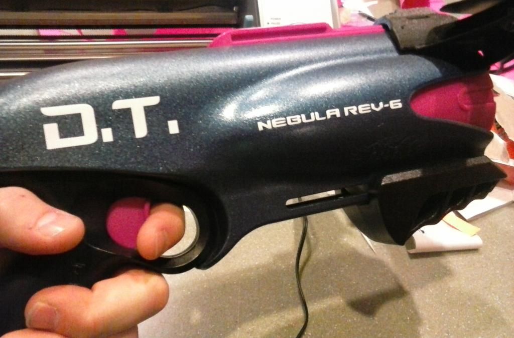

So I looked into the box and found some heat transfer stuff and decided to give that a try. I was actually able to iron them onto the side using medium heat (the "wool" setting.) It took about 20 seconds of rubbing the tip of the iron in slow circles to complete the transfer. After about a minute of cooling time I applied an extra coat of clear enamel over that side of the blaster to really seal it in. Its staying on very well. With effort you could probably pick them off but you would would have to scratch through the clear coat first and unless I drop it directly on concrete it should be fine.
This is what the heat transfer looks like on a modified rebelle guardian crossbow. I made this one for my little sister's birthday and we dubbed it the "Nebula Rev-6." The best part was when she saw the lettering for the first time and actually grabbed the blaster out of my hands and hugged it! So yeah I think I'm going to be doing this more in the future. :)

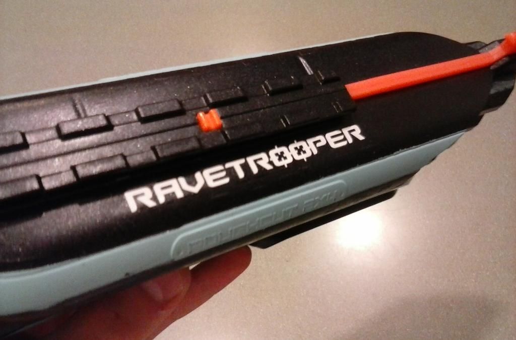

Posted 08 November 2014 - 07:21 PM
That looks really sweet. Does the heat transfer stuff cut just like normal vinyl sheet?
It works in a vinyl cutter, but you have to adjust the blade height so that it only cuts through the top layer and not the adhesive.
NOTE: always reverse your image (left/right) before you print on heat transfer because you actually flip it over when placing it on your surface.
This is an example I recently put on my modified roughcut:Posted Image
...I use 110 lb cardstock, print an outline, and cut with an exacto for spraypaint stencils...
Thanks for the idea, man. Sick lettering is in my future...
This was my first method but I stopped due to not being able to get a good edge seal. I was using masking tape though, what did you use to adhere the cardstock to the blaster while spraypainting?
Edited by ravetrooper, 08 November 2014 - 07:31 PM.
