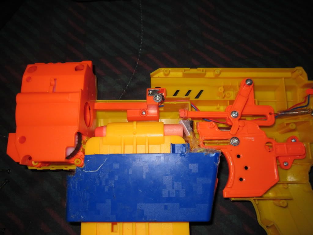

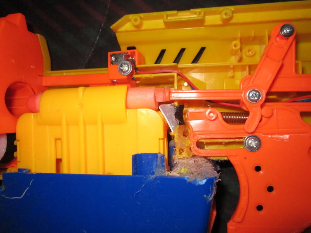

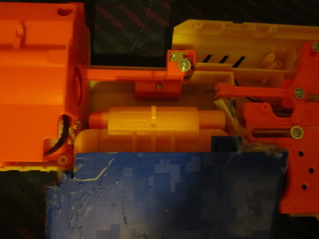

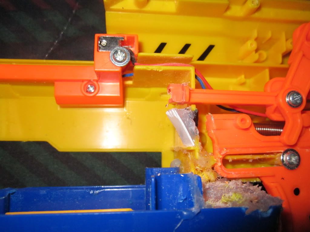

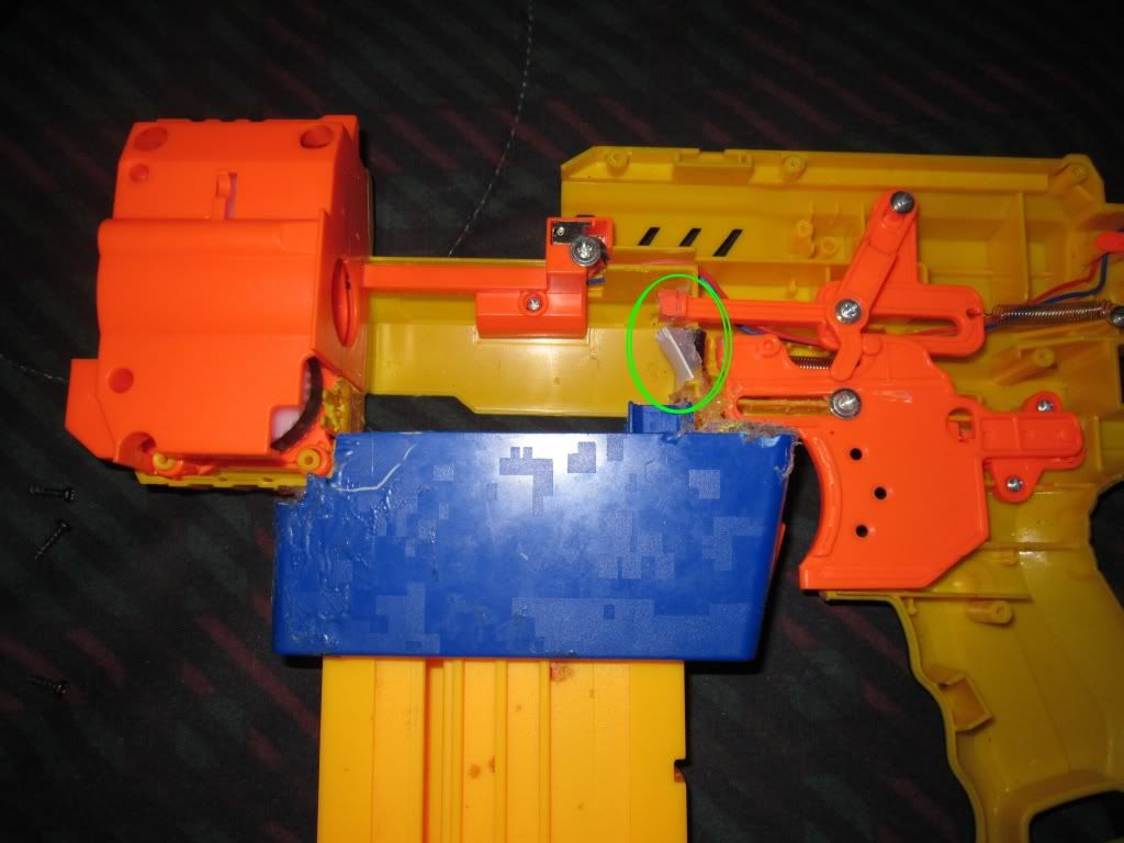

Its nothing too innovative, or super extra special. I just added a feeding ramp to the clip well. Pictures as follows:
Like I said, it really isn't anything mind blowing. But it does the job of putting the darts where they need to be.

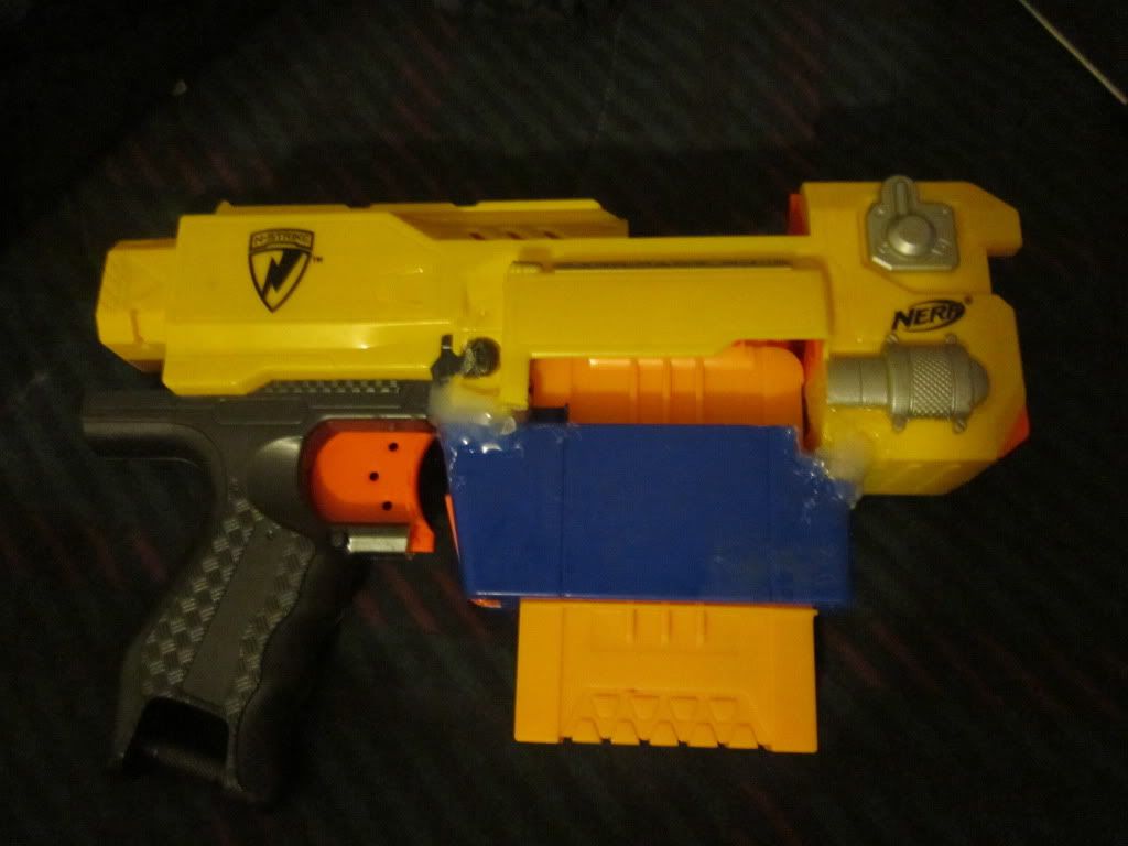

As you can see from the pictures I've did the normal taping of the fly wheels with electrical tape (which is not optional if you want it to work with streamline darts).
I also removed the barrel and increased the voltage with 3.6v batteries.
I only glued this half so I could show you guys the inside and so I could work on it if needed in the future.
Well that's it. That's the Blood Angel Barricade. A normal Barricade Clip Mod with an added feed ramp. But that feed ramp changes EVERYTHING.
