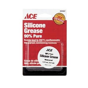

I ONLY use this stuff:
Of course, you can use a different brand, but you must make sure that it is silicone grease. Anything else can be potentially bad for the plastic and rubber parts (most notably petroleum-based lubricants) that make up your blaster. Try to wash the lithium grease out, replace the rubber seal, and try again with the proper lubricant.
I'll second this. I had it suggested to me by Beaver (of the awesome rainbow catch design). It works marvelously.
