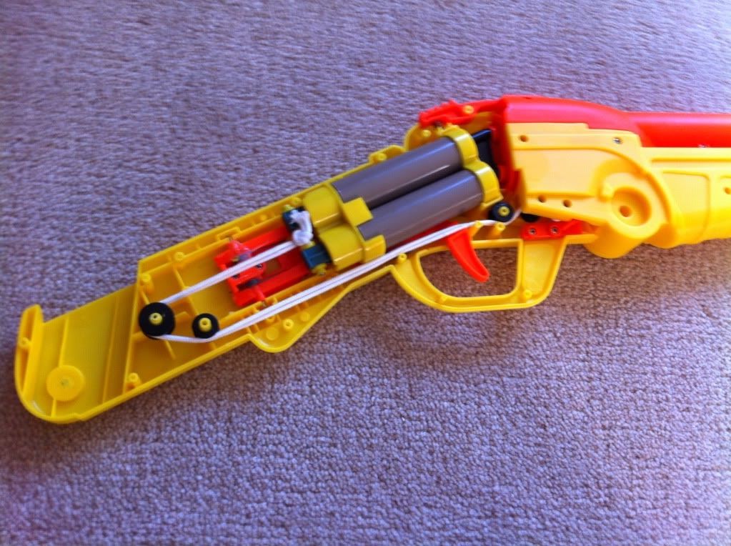

I dunno if you went over this or not, but I also noticed that the big pulley system in the back is gone and has been replaced by like 2 or 3 pulleys more conveniently located in other places of the shell.
Yeah i saw that, it makes cocking easier and it stops the string fraying or snagging on any sharp plastic or screw ports inside. They also dont extend the string by much so when i minimise, they wont get in the way.
