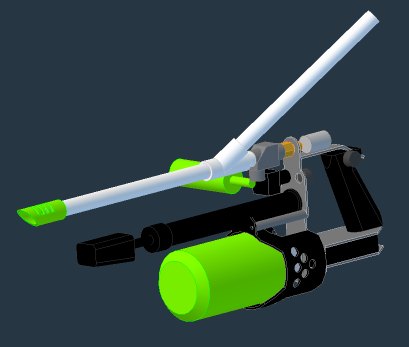

Working on this one kind of slowly at the moment. The goal is to have 6 semi-automatic shots available whenever the 75ci tank is primed.
It's very similar to the QEV blaster that Doom made. The high pressure tank is down-regulated to between 15psi and 30psi to fill the low pressure tank. The Quick-Exhaust valve is piloted and refilled by a 3-way solenoid directional control valve.
Only differences are
1. I wanted to keep all of the pneumatic components metal and pressure-rated
2. 3-way control valve is a 12v solenoid valve
3. Solenoid valve is powered by a 12v battery (AA x 8 battery box)
4. Solenoid circuit is triggered by a push-button switch mounted in a joystick grip
5. Includes a hand-operated pump for recharging high pressure tank, with a stem valve as a quick refill option
I'm also making the 7ci low-pressure tank a modular item so that it can switched out for a higher volume if I would like to be able to fire arrows or foam balls.

Some revisions based on how the hardware/fittings are going together.
Edited by CaptainSlug, 12 February 2011 - 01:50 PM.

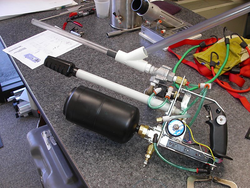

It's built and it works. I need to do some fine tuning. I also need to get a better regulator because the one I have been using is proving to be a significant bottleneck in flow rate between the high-pressure and low-pressure tanks.
The RF20 pump isn't very good, but one 40psi fill will net me 9 semi-auto shots.
I will post with more photos and specifics soon.

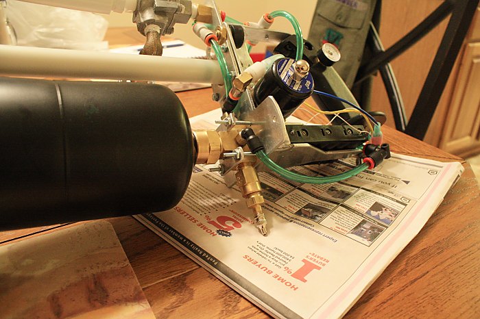

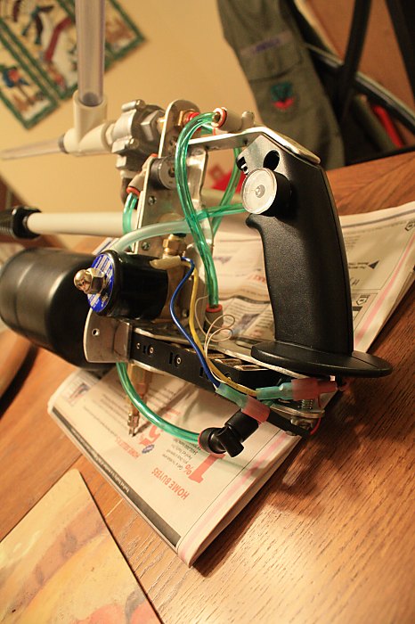

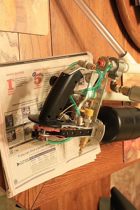

Here's how it works at the moment.
1. The high pressure tank is down-regulated to the firing pressure. Which is supplied to the low-pressure tank through a 3-way valve that's setup for Normally-Open.
2. The low-pressure supply pilots the Quick-Exhaust-Valve through the Inlet port sealing off the Barrel, which is connected to the Exhaust port on the QEV.
3. The low-pressure tank is connected to the Cylinder port of the QEV.
4. The low-pressure supply is also connected to a 2-way Normally-Closed valve.
Once the two solenoid valves are energized the 3-way valve cuts off the low-pressure supply. At the same time the Inlet port is vented of back-pressure through the 2-way valve.
The venting of back-pressure causes the low-pressure tank to fire the dart from the barrel.
The 3-way valve also vents the back-pressure from the QEV, but has too low of a flow rate to quickly pilot the Quick-Exhaust-Valve. If I had one with a much higher flow rate is could perform both tasks.
Posted ImagePosted Image
I got to practice aluminum welding while making the frame that all of the parts mount to. The yellow-top part is the 3-way valve.
The blue-labeled part is a 2-way solenoid valve meant for controlling air horns. A wing-nut holds the 8 x AA battery box in its hinged bracket.
The high-pressure tank is actually a throwaway propane tank. The 1/4 NPT adapter for it is screwed into a tee that I added a couple extra 10-32 UNF ports to.
An optional tire stem valve is included for refilling from a compressor or a more effective bike pump.

1. You could probably get a good 10% more energy going into the hopper by turning the QEV 90* and having a more pancake-shaped tank feeding directly into it.
2. that this was moved from your sekret forumz?
3. How many shots are you getting from each fill?
4. What's the parts cost on this thing?
1. Interesting. The tank shown is a leftover part from work.
2. Yes.
3. At 40 psi unregulated I'm getting 8-10 shots. Once I get a better regulator and a better pump that number will improve.
4. I'll make a part list an cost estimate once I have the parts finalized. But it's not a cheap project. I haven't tracked costs closely, and a fair number of the fittings I took from the leftovers bin at work.
I'd guesstimate $175.

So in fact it is almost a PB marker... only this one can be pressurized in the field, kudo's for that
Is it possible to use a manual operated valve instead of the solenoid?
It would have to have a high flow rate in order to pilot the QEV quickly. Which would mean it will probably be expensive, or large, maybe both.

@Draconis: Modify? It's just a matter of threading on one of these adapters and possibly removing the valve core from the propane bottle to improve flow. No big deal really. In fact I made this same suggestion to Doom some time ago as an alternative to his Catalina cylinder.
CaptainSlug: "It would have to have a high flow rate in order to pilot the QEV quickly. Which would mean it will probably be expensive, or large, maybe both."
I disagree. The MJVO-3 should be adequate by itself, and if not, you can make a QEV cascade using the MJVO-3 to pilot a small [inline] QEV which the pilots the larger one. It would cost less than the Mouse valve, take up about the same space, and eliminate the batteries as well the weight associated with them.
Yes, rated for 25 scfm @ 100 psi the Clippard MJVO-3 or MJV-3 should be able to pilot a QEV fairly well.
I'm not sure where the floor on SCFM is for piloting this QEV, but I suspect that anything below 15scfm @ 100psi is not likely to work very well. Getting it filled and sealed is much easier than exhausting it. That can be done with a valve rated as low as 1 scfm @ 100psi.
I'm going to order a surplus MJV-3 to test it out. I have a tiny QEV in my parts bin if I need to try that as well.
