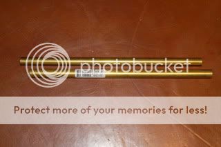

For this mod, you will need 9/16 and 19/32 brass. 9/16 is the barrel, and you will need more than a foot of it. You will only need about 5 inches of 19/32.
Cut 5 1 inch segments of 19/32 brass. One for each barrel.
