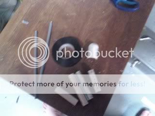

Open up your longshot and take out everything. The only parts you will need for this portion of the mod are as follows:

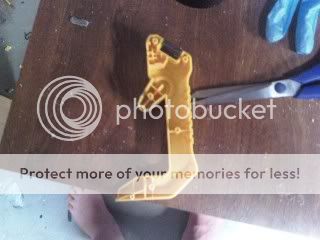

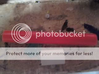

Now take the shell and Prepare to reinforce it.
You will be reinforcing this:
This part of the mod is important because it increases the life of your longshot.
I used knex and hot glue to reinforce, but you can use any thing that you want.

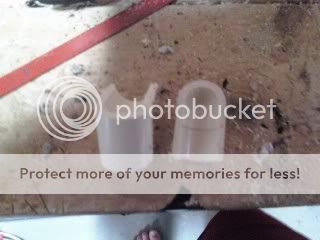

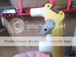

Take out your bolt. Remove the back screws, take out the spring. Cut the bolt and remove like so:
Now take some ½ in. cpvc and single your long shot with it like so:
The cpvc runs through the back of the piece and is hot glued in place.
Now superglue it to the back of the plunger chamber.
Next glue on a ½ in. cpvc coupler.

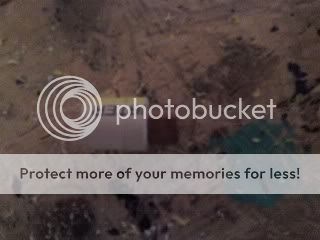

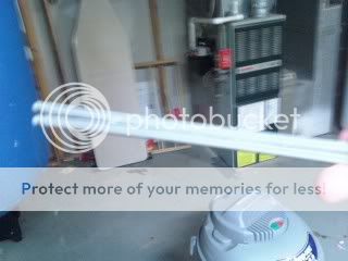

Now cut yet another piece if ½ in cpvc and insert half or it into your desired length of ½ PVC. (This will be for the inline clip, what ever length you choose is the length of your clip.)
Glue it all together and you should have this:

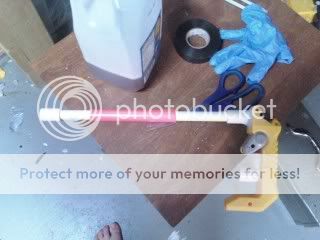

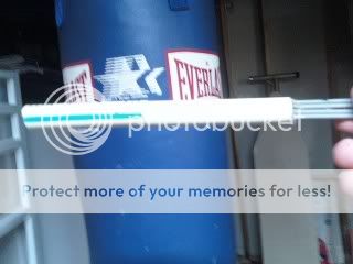

Next take a small length of PETG and E-tape both ends so that the one fits snugly in the PVC and the other in a ½ in. cpvc coupler.
Glue it all together and you will have this:
Congrats you just inlined your Longshot.

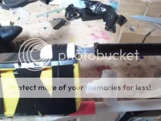

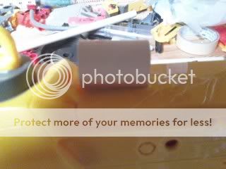

Now take your plunger out. Now cut a small length of ¼ in. copper tubing. Super glue it into your Plunger rod.
Then put ½ in. cpvc over the copper that is hanging over. Superglue it in place.
Next add what ever springs which you desire, strengthen the catch spring and put the gun back together.

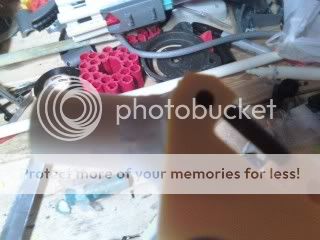

Now take a ½ in cpvc t-coupler and drill a hole through the coupler.
Once the hole is drilled insert the cpvc from the back of the gun and then screw it all together.
