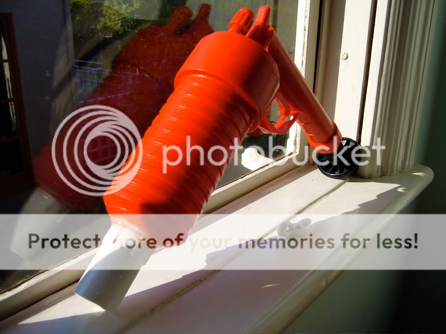

I picked up a Cobra at Lowe's a week ago and decided to see if I could make them the ultimate defend the core weapon. I think I've achieved that task. Here's what I did to it.

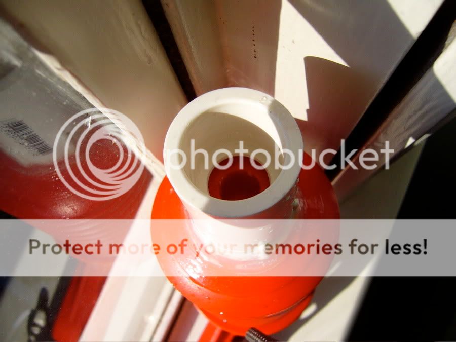

The first thing I wanted to try was creating the ultimate ball gun.
Nothing special here, I just added a 1.5" PVC coupler and put on a 5" segment of PVC. I'm using the practice gold balls you can find at Target. Thanks to Draconis for helping me with this.
Results are mediocre in my opinion. It shoots a single ball around 45-50'. But this is where it gets fun. When I went to Armageddon this year, Bags was using a signal launcher for a ball gun. He would load one ball, then a bunch of 1/2" stefans, and then another ball on top. Look at this video. (I put five darts in there)

I must admit, "little" is relative in this situation, as this gun has a 400 mL airtank. The Cobra has 750 mL. The Titan is probably less than the Jobar.

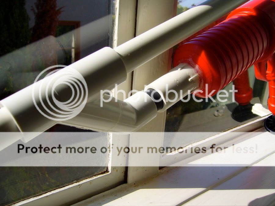

Since I was in desperate need of a backup blaster, I just gooped on a half-inch coupler:
All you have to do is hacksaw off a quarter inch of the nub at the front of the barrel, pull out a crossbar, and goop a coupler on, and this monster will be firing darts like no other.
To make it war legal, I was forced to do this:
I have a two-foot clip for that BRISC setup. And when it's empty at twelve or so pumps this thing is easily passing eighty feet. I was forced to use a CPVC barrel, even though my darts are tight in PETG, because otherwise this thing would shotgun fire a third of the clip. Not that I'm complaining, though; I can fill that SCH40 clip and fire a cloud of darts past forty without too much of a problem.
I'm picking up a Cobra in Chicago, as the Jobar is going to stay in LA as a backup blaster; with proper but simple modification one can easily turn these things into poor men's Lightnin' Blitzes.
