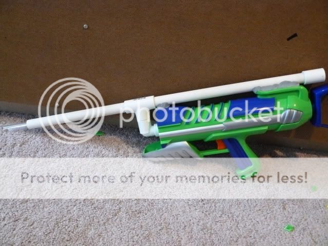

So I was at target the other day, perusing the nerf section, when I saw an abundance of BBBB's on clearance for 5 bucks. I had to pick one up. I originally couplered the gun, but decided it needed my standard of ROF (my main primaries are my LS and clipped PAS). So I RSCB'd it. I did it a bit different then everyone else, because I'm obsessive about having straight barrels and as little as possible deadspace. Onto the write-up.

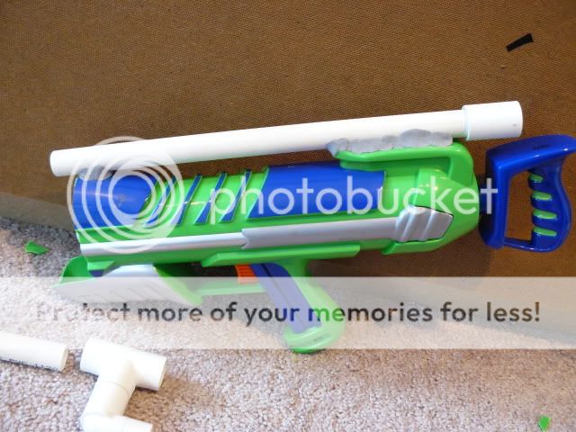

Now cut your shell like so.
Also cut a hole for the coupler.

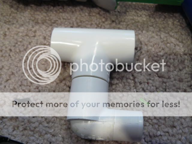

Now begin assembling your RSCB with your street elbow. Make the part of the elbow that makes it a "street" elbow the part that will be inserted into the coupler.
Now start making some cuts on the shell. The first, deeper cut in the picture fits the end of the tee. The second fits the PVC holder section of the RSCB.
Here you can see how the tee fits into the first, deeper notch.
Now cut down the back part of the shell so the PVC holder section will fit. The best way to do it is go really slow, constantly test-fitting. Also make sure that you take equal amounts of material of of each half of the shell.
Now cut a holder section and glue it down. DO NOT GET ANY GLUE OR PUTTY ONTO THE TEE. I just used putty because I was low on super glue, and too lazy to deal with epoxy. I would recommend actually epoxying or super-gluing it down first before adding putty. Another thing: ONLY ADHERE THE PVC TO ONE SIDE OF THE SHELL. You're going to want to be able to open the blaster in case of a trigger break or something.

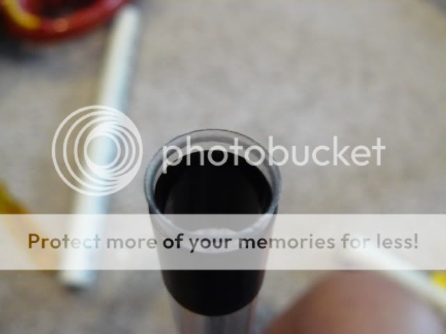

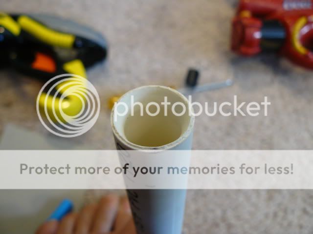

Onto the barrel. Funnel out the PETG on one end.
Do the same to one side of a PVC barrel sheath you should now make.
I did this to both pipes by twisting wire cutters like so. Apparently the corners are sharp enough to cut into it (and obviously it can bend the PETG).

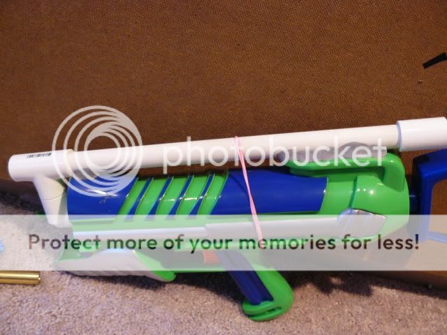

Now wrap some e-tape around the PETG and goop it into the PVC. Make sire the funneled ends are as flush as possible with eachother. Now you can assemble you RSCB.
And the best part? You can still remove the RSCB by tugging on the elbow and tee.

And you can put on other attachments...
Ranges: For some reason the gun shotguns 2 darts each shot. These 2 darts go about 65 feet before hitting my fence with about halfway drop. When I just load one dart in the barrel to prevent the shotgunning (obviously with the clip empty) it hits the fence without drop. And this is unplugged. I'm very happy with it. Now I just need to figure out the shotgunning problem. I'll try flipping the barrel around (the funnel might be being too helpful in loading darts, ha ha).

A shotgunning RSCB means your barrel material is too loose.

For your two dart issue, how tight are your darts in PETG? If they're too loose (or really, loose at all), that could be cause for it to shoot two. If you don't want to change barrel material, Badwrench came up with a wooden dowell solution to stop extra darts, it's rather interesting. Here
Also, to eliminate more dead space (if you have the tools), you can cut down the T and L couplers (which isn't quite as do-able on the BBBB because you'd either have to put your rscb on the side) or cut of a bunch of the shell. Also, if you have a drill press, you can drill out the PVC so that CPVC will fit inside, thus reducing the dead space. However, if you do not drill it out and just pound CPVC in, the PVC will expand and no longer fit inside the coupler pieces.
Yeah, that's probably another factor. I'll nest a bit of 17/32 brass at the beginning of the barrel and see if that does the trick.

Thanks for the info. I had considered badwrench's set-up, but I decided not to because I wasn't all for my darts getting smashed by a wooden dowel. The darts unfortunately don't magically stay out of the tee section when you fire, but I really wish they did. Then again, I'm speculating this. I may try it out with a brass poppet system.
