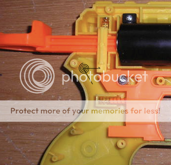

I've always used the stock springs in Daedalus. Just to make public what I PM'd you, just cut the notch where the trigger latches deeper. That's what I did, worked fine.
EDIT: It looks like this:
You can see the new notch that was cut farther up and deeper than the original. Its better than the MS Paint I PM'd you.
